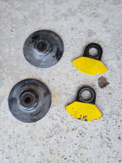

I did the install today. Took less then an hour. and I did one at a time. The rears you just take the bolt out, the black cap comes off and you put the piece in. The fronts you need to take the plastic cover off that run towards the front of the car under the gas tank. There is one on each side. For the front I loosen the bolt but left it on. There is a metal yellow tab you need to remove. Use a breaker bar and you can pry it off, you don't need to drill the side to get it off. The front just pushes on. I torqued the bolts to 126 ft lbs. They sure didn't feel like they were on that tight when taking them off
