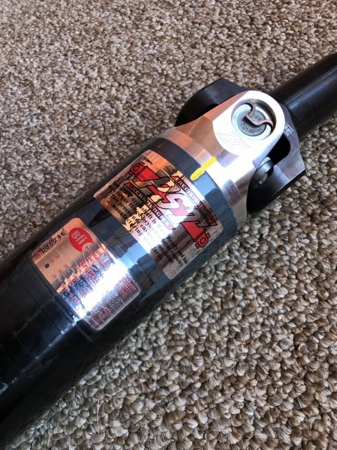

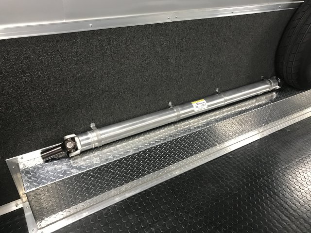

They’re not. Friend with one in Calif broke his on the first pass. I have a PST CF as my primary and a Raven Engineering aluminum as my backup. 6C916A93-D611-4D6B-9180-06F88ADCC955.jpeg 74A263F4-9460-43CA-81A3-91C3CBD3C80F.jpeg

They’re not. Friend with one in Calif broke his on the first pass. I have a PST CF as my primary and a Raven Engineering aluminum as my backup. View attachment 104662 View attachment 104663

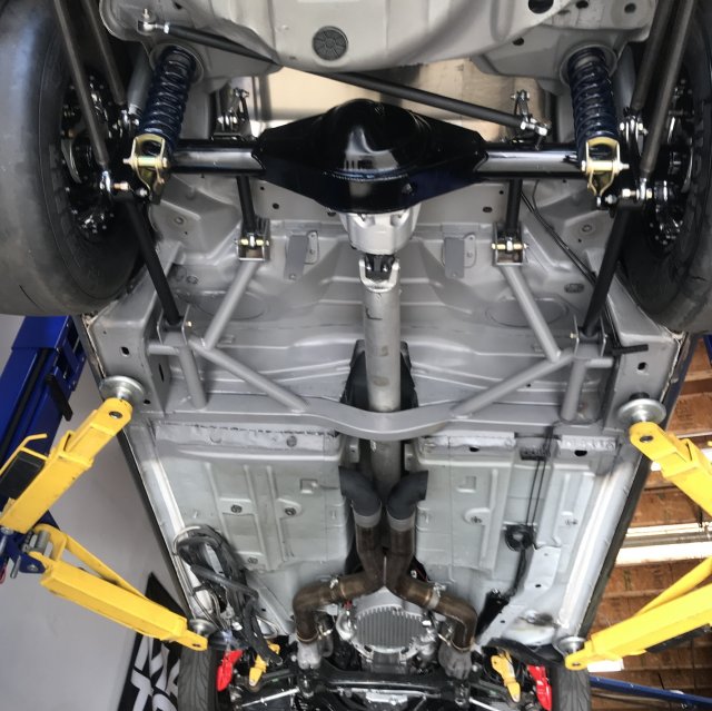

What rear do you have in the car? 9” conversion? That and the th400
Strange Engineering DragPak conversion. 3.40 Pro Gear with a 40 spline spool. D7F0ED9C-EE18-4BC0-B694-B86A4FFA2E8B.jpeg
