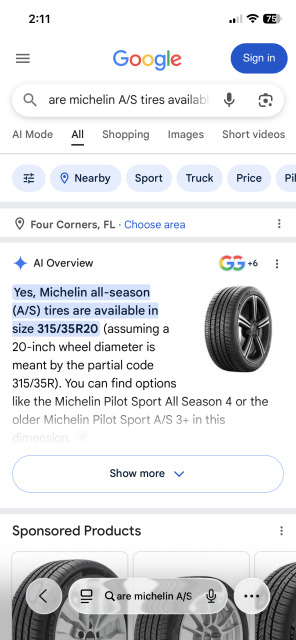

Agree with Michelin’s but you probably know any performance tire has limitations in bad weather especially in cold weather. You are apparently concerned about wet weather. I loved the Michelin PS4 A/S tires on my Daytona. IMG_1988.png
