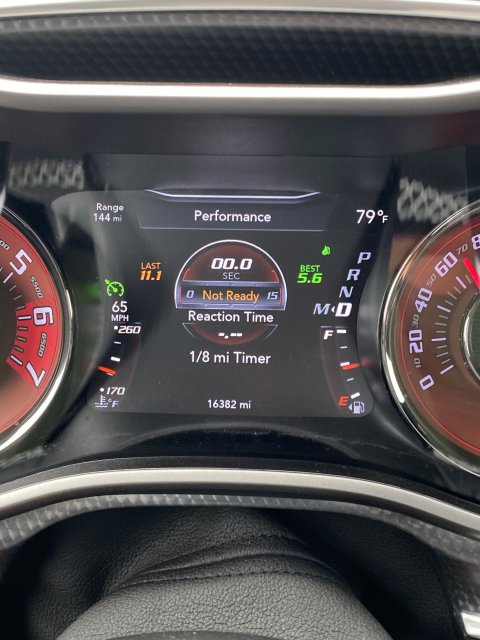

I just bought my Challenge hellcat wide body. I was going thru the best times stored on the cars memory and the guy before me has the best 1/8 mile in 5.4 sec. how is that even possible. I bought it all stock. I think he did do something with the exhaust but he put it back to factory when he sold it.

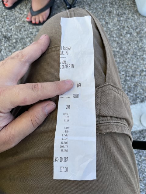

5.4 in the 1/8th is moving. Im a 10.0 car and this was my latest time in crap DA.

An extended burnout might explain it.
100% makes sense, while you're at it if the top speed says 202 it is a burnout for sure. Otherwise you have one of the quickest hellcats ever.

That is possible because the previous owner did not know how to reset the timers after he did burnouts. Definitely a burnout time. It won’t do five second 1/8th’s. A smoky one busts up the 0-60 and the 1/8 mile easy.
RESET IT AND START OVER.

Most timers do not use the rear wheels. I would think the timers are done by GPS
8,605
52,856
It is the rear wheels. It uses those “tone rings” that are a PIA when you blow an axle. Last fall I smoked a racing set of tires one morning. Had to reset the timers, it really screws them up. The 1/4 mile held correct because I did not burn 1/4 mile worth of rubber. I won’t do it again.
