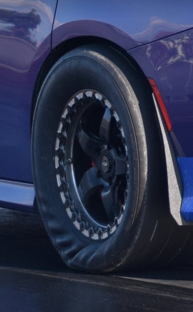

So launch control didn’t ruin your run once you lost traction?
Nope. If anything the opposite.
Can't say the track wasn't prepped either:
