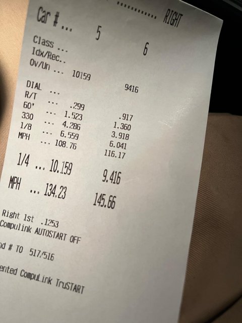

9.4@145 on the new set up.…..super stoked. I believe we can get a 9.2 in better DA. This run was in 1600 DA with temps in the mid 70s.
2.72 upper
1200 FIC injectors
E85 and a tune……that’s it. Otherwise a completely stock Redeye running with complete factory exhaust, axles, driveshaft and cats on a 305 Street R tire.

Great short time too, good job!
Nice pass. No doubt with negative DA she can drop another 3 tenths. As long as the 305's will hold. May need 315's at some point.

Yes....eventually I'll have to go with a 315 and upgrade the axles and driveshaft.
