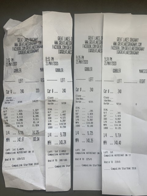

I can tell you what kind of gains can be made…. Consistent sixty’s. A Heavy IRS can (and have) thrown down some impressive sixty’s on a flypaper track. Those of us who have experienced a on point radial prep know what that is. That happens, and a time (that will be from that point on be used as the example of what you run) will be produced. No reason in pointing out that you can’t hook for shit under normal conditions. My car does not run less than a 1.35 sixty now. Even when it is spinning the tires, it is accelerating. That’s the difference.

I can tell you what kind of gains can be made…. Consistent sixty’s. A Heavy IRS can (and have) thrown down some impressive sixty’s on a flypaper track. Those of us who have experienced a on point radial prep know what that is. That happens and a time (that will be from that point on be used as the example of what you can do) will be produced. No reason in pointing out that you can’t hook for shit under normal conditions. My car does not run less than a 1.35 sixty now. Even when it is spinning the tires, it is accelerating. That’s the difference.
Yep, hard to argue with a 4 link not being the best for no prep. I can attest to this. Speed world they light the track on fire (1.500 flat 60), Gainesville they spray it. 60’ was noticeably worse (1.57), but still in the 1.5.

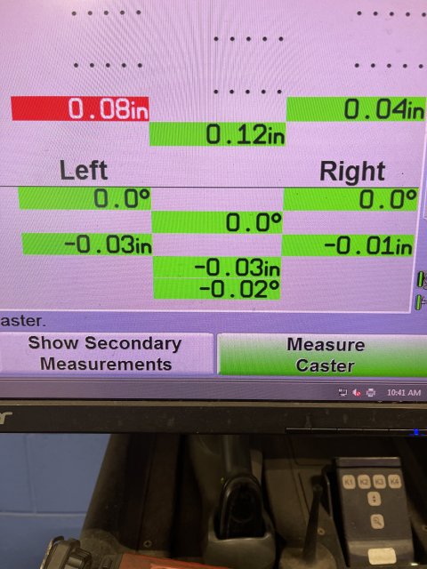

If anyone on here had a Redeye, I’d love to see a stock alignment readout
While I don't have a stock alignment readout for my Redeye, I can tell you that the stock knuckles won't give you zero camber. I installed the AAD rear kit this winter and had the alignment done a couple of weeks ago, to get it to zero camber I had to use tabs that made the arms a fair amount longer than stock length. Also, having the rear alignment at zero camber is noticeable to the naked eye, there is no mistaking the stock settings for zero camber after having completed the alignment.
I agree with @vortecd , just get the upper arms if you don't want to drop $1,500, they will do what you need.
