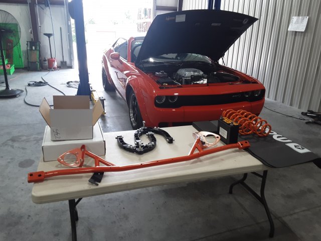

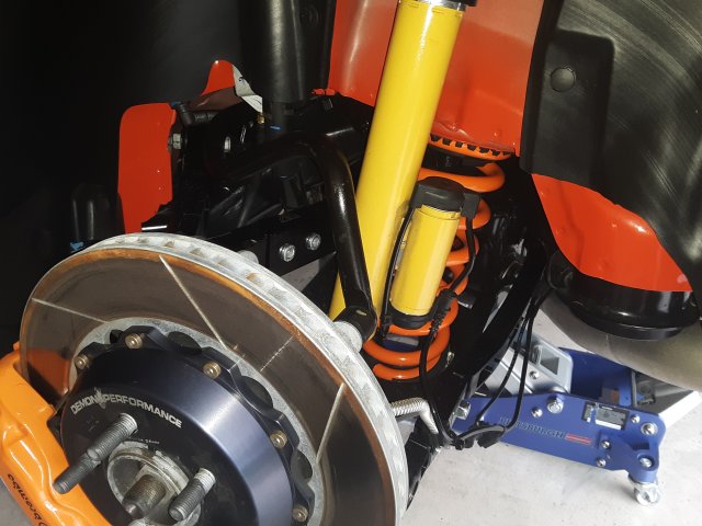

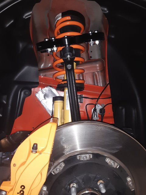

I and a couple others tested the R&D HHP Drag Springs. They are modeled after the Demon ones except they are black in color. They do help the transfer of weight during the launch. My 60ft also dropped to a 1.38. And a best of 1.36. I'm sure it will get even better once I get back in the groove next year. My originals have been replaced now to the new version.
With the weight of Hellcats building and strengthening the rear is always a good thing to do.
