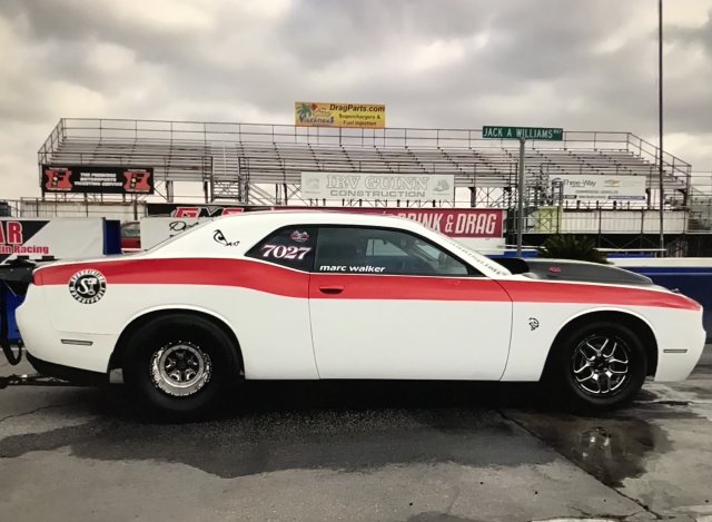

I put about 500 miles on the 18” Winlites with M/T Sportsman tires under normal around town and freeway miles. No issues. They drive, steer and stop nice. The Winlite is a superior wheel. 0D076FFF-2E7A-4E6C-8797-B6F6F0AB0228.jpeg
