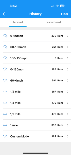

41k miles on original pads and 2pc rotors. With coming up on over 5k miles of Drag & Drive towing a 1300lb trailer with it. I've probably got over 50 passes as well on them.
3,685
8,688
2016, 23k on mine, original pads with 50%+ life still on them and I have done literally hundreds of 60-130 runs and 1/4 mile passes.
