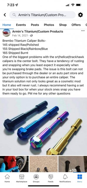

Brembo Six Piston Caliper Bolt.

I reached out to them before I bought them. They confirmed they will fit.

Got them yesterday. Talk about great service. They look fine, the male end threads in easily. Hopefully, I'll never need them.

You can also get them in a complete hardware kit from Rock Auto or a jobber under these names and part numbers.
Carlson #H5959 or Raybestos #H5963A.

I'm currently replacing the brakes on my 2018 Trackhawk and I noticed that the previous owner must have swapped out the retaining bolt for a different one at some point because A) the cap head ISN'T a 13mm head, B) the concave section of the bolt doesn't align with the spring clip, slide pins or disc.
I'm not 100% sure if this affects functionality to an appreciable degree, but given the fact that this particular bolt cannot be purchased seperately from MOPAR or Brembo, it makes sense to me now why the mismatch.
I dunno, in the interest of being thorough/by the book, I'm ordering the parts as linked above, so again: Many thanks for the info!
