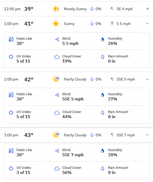

New England Dragway opens Wed April 2, the DA forecast is incredible, -1500'! But we're looking at 43deg.
Does anyone have experience running MT ET Street R's in cold weather?
I'm thinking about the $175 track rental but if there is no chance of getting really good runs I don't want to waste my time and money.
Does anyone know if the MT's will stick enough to take advantage of the DA? I called MT and they said to give the tires a little extra warm-up, but would not say if there would be significant loss of traction.
I need to know now as I need to prep the car Tues April 1. Thanks!

Wed forecast: Some sun, cold, slight tailwind:

DAMN!!! I just called to reserve and they said no one was signing up and they cancelled tomorrow!!!! :mad::mad::mad: And they said no one has signed up for Friday either!!!!
Thanks for the help guys.
