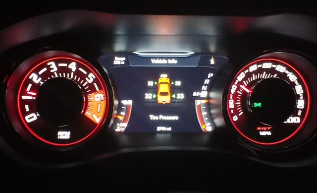

Ok probably a stupid question but I can’t seem to view the tpms screen in vehicle info . On my scat pack it was the first screen that popped up in that menu . 2016 Hellcat .. I know there are added screens for boost , inter cooler etc .. but thought it would still have this screen

Did you use the arrow key to scroll down?
4,694
18,927
Works on mine, 1 arrow up from the max MPH display !

Yes so I’m in the 2. Vehicle info menu , if I scroll using right or left arrow keys I get the different screens coolant temp, torque , hp, oil temp , trans temp etc , boost gauge etc ( I forget the order ) but no display of the tpms screen. Maybe I’m looking in wrong place ?

TPMS is the first screen in that particular menu. (Info)
If it's not there, that's strange

Yeap that’s what I thought now I’m concerned the system has been deactivated. I looked for a Tazer maybe previous owner had one but haven’t seen anything. On my scat it was the first screen under info . I thought about disconnecting the battery or not sure if there is a fuse I can pull :unsure:

Yes, the TPMS & Top Speed info is in the DID !

Down arrow (left side steering wheel) once.

so if I hit down arrow once I’m already in vehicle info screen 2 it should come up ? Cuz the first screen that comes up when I hit down from 1. To 2 vehicle info is not tpms I’ll have to try again tomorrow morning . Sorry for the dumb question it’s what I get for not sleeping due to schedule.

Use the L/R arrows on the second screen to move...you guessed it...left and right. It's there.

Very bizarre it is NOT there... not sure what is going on. I have the following (and not in this particular order persay after coolant temp) when I scroll down from 1, to 2. Vehicle info the first screen I see under 2. is Coolant Temp, Trans Temp, Oil Temp, Battery Volt, I/C Temp, Boost, IAT, Oil Life, engine Hp, torque. I seem to be missing the TPMS screen and Top Speed (assuming top speed is under Vehicle info as well) I am going to try calling Dodge today.. I was going to disconnect the battery maybe something just needs to reset not sure. I have no TPMS warning light and car has stock tires and wheels. Very puzzled o_O:unsure:

I think I finally figured this out prior owner must have disabled the system. I also noticed today when not wearing my seatbelt just as I started to drive the chime has been shut off . The seatbelt red light still appears on the gauge and the display pops up once with the picture of driver seatbelt not buckled but no constant chime. Back to tires tpms we can see all 4 tires have sensors .. rear tires are almost new. I’m gonna go by a buddy shop that’s a mechanic and has owned and worked on these cars quite a bit . He’s going to plug in and scan everything to see if system is disabled which I’m almost sure it has. I disconnected the battery but that didn’t do anything but tried it just in case .

With AlfaOBD, you can check the status of your TPMS programming, in the BCM, and turn them back on, if they are disabled.
You'll need to download AlfaOBD on an Android device, and an OBDLink MX, or MX+ OBD client.
You'll be looking for TPMS status under Base and Premium TPMS settings. If they have been turned off, current status will read "not set".

Thanks Bob for the information I appreciate it. I don't have an Android device and part of this sounds a bit above my technical level, so hoping when my friend plugs in at his shop he should be able to access this as well.

If you have access to a Tazer, it will also allow changes to the TPMS settings.
