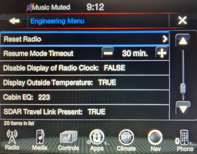

With ACC power on, press and hold Driver's temp UP/DOWN buttons, after 10ish seconds the Engineering menu pops up, then scroll down to Reset to factory default.
I'm not sure I would do this until you've exhausted everything else first though.

My Challenger is a MY16, worked as described, my DSRT is a MY19, I could not get it to work, perhaps it's a different key sequence?
My Power Wagon is a MY17, and it worked
1,934
3,869
Thx for checking, must be something different for '18 or '19+ models. I saw a youtube video that just said to touch the top left corner of the screen until it resets, but it didn't do anything for me.
