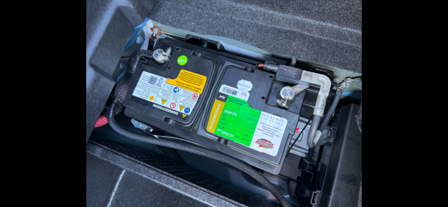

About to change the battery, been over 5 years now and these colder mornings have me not wanting to chance it much longer. Took a look under the trunk cover, looks like 2 10mm bolts on the terminals, only thing is the battery appears to be attached to the car on the side, to the passenger side of the car? Didn't look immediately obvious to this non-mechanic how to free it, so I ask if any of you have encountered this and in there an easy way to pluck it out? Thanks!

Look closely at it. You can figure it out.

Don't overlook the vent tube, but you should be able to figure that out too.

That’s probably just the hold down clamp, loosen that and it’ll come up

Yeah I did see that, was going to include that in my first post but forgot. I assume the new one will have this too. The last battery I changed myself was back in about 2010 in my 300C SRT8 and back then they didn’t have the tube if I remember correctly. Anyway - hope to get to this over the weekend and will report back!

I did mine, release the strap, loosen the terminals. My lithium replacement required MUCH less effort than that heavy old one to put in.:giggle:

Well in a not-shocking manner my battery died today after I got home from work. Fortunately my neighbor was home to jump me and I drove straight to Costco and had to buy an Interstate AGM battery for $180. Had to pull and install on site. Bottom bracket revealed itself once I pulled everything out of the trunk to swap. Unfortunately the vent tube is a different size and does not go into the feeder hole in the battery. Think it is ok to wait to Sunday afternoon to future that out? I am a wrestling coach and we are wrestling today and tomorrow…and Sunday morning lol. I will be driving the car.

Yeah, just a vent for the gases. It should be hooked up but shouldn't matter much for a few days unless your alternator is over charging the battery.
