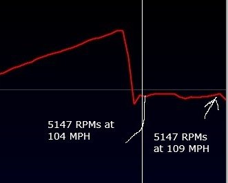

It acted like a snowmobile clutch, RPMs didn't change but the MPH increased from 104 to 109 as the converter clutches were trying to engage.
I am sure it didn't do the clutches any good and was wondering if what I was trying to accomplish is even possible with these modern factory converters ? Increasing the apply pressure and fill time didn't seem to change anything, so I will just forget about trying that again.

Attached is a snip of the 4-5 shift and the attempt to lockup soon thereafter.

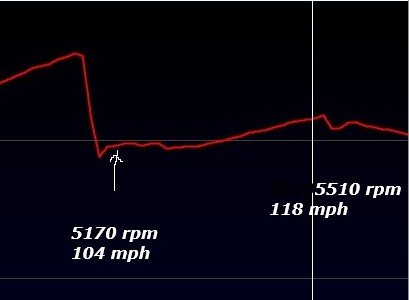

Here is another 4-5 from the 30th, and it calls for the lockup at the end of the shift/beginning of 5th same as before. Note the MPH climbs substantially from 104 to 118 but the RPMs do not climb all that much. It appears the clutch starts to take hold when the ramp starts upward. I won't mess with doing that again until I get more information. There are 2 or 3 clutches in there from what I understand now, I would think there would be a way to get them to apply firmly and quickly with the available adjustability. I have HPT but I am not going to screw around without a clue.
It's not all that big of a deal I guess but I am curious
