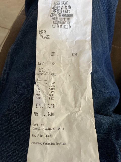

It is attached. :)

Done!

Local tuner or bigger name? Jon data logged my stock car last weekend and I thought he said he saw 11.8. DA was around 0. Now keep in mind, with higher DA you loose boost being there isn't as much air to compress
Also the bigger cube engine is going to flow more air which will make the boost drop. Boost is back pressure so for instance if you put a 2" exhaust on your car boost numbers would go up but it also would probably be slower

Why I told Bull to go with smaller pullies being the altitude

Sometimes in the summer I see da s of 7000 feet. Tracks is at 3100 feet. Temp. was 83 with 20 percent humidity and 29.9 pressure. Yes 7.0 liters with a ported snout, 2 inch headers and 3 inch exhaust. Plus the higher da.
