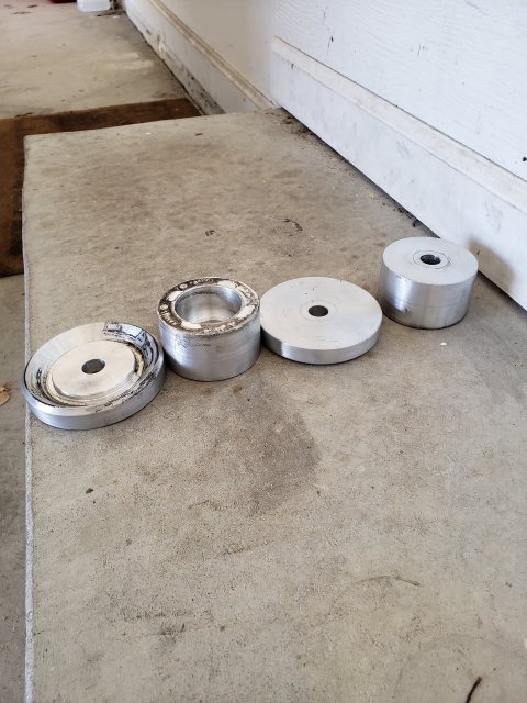

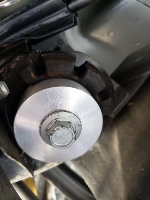

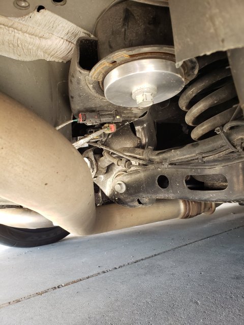

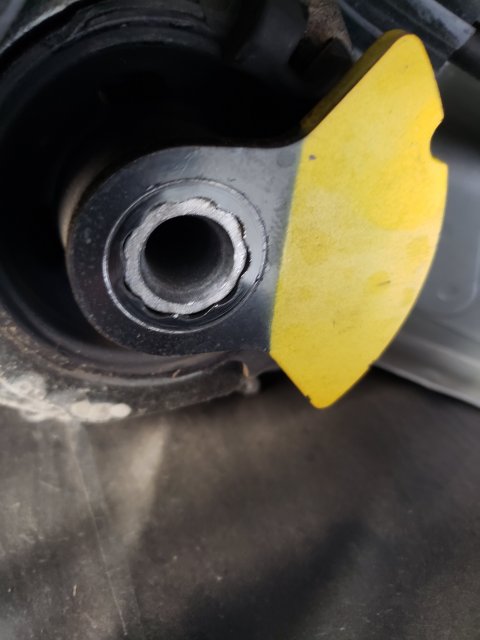

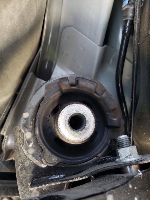

Installed them on my dad's Challenger T/A today. Used pry bar on one side then used vise grips to pull the tab off rest of the way. On the other side was ably to pry it off. Just don't take the bolt all the way out so the rubber doesn't flex to much. You don't need to drill out a side to get them off

I had to drill mine out to do my lockout. Wasn't a big deal

I still had to use the pry bar after I drilled it out. Would not come off with just a pry bar

Thing I don't like about the BMR is you need to trim the rubber, these fit inside so a little easier

Mine pried right off to. I did try prying on them with the bolt out, doesn’t work. Like vortecd said put the bolt in a ways by hand and they pry them
off.

I don't recall having to trim any rubber at all. I have the BMR ones. Small rings sit inside on the top to take up space, and larger ones go on the bottom
