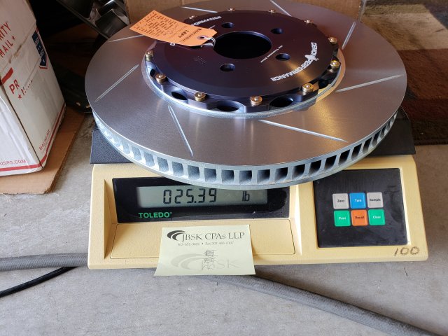

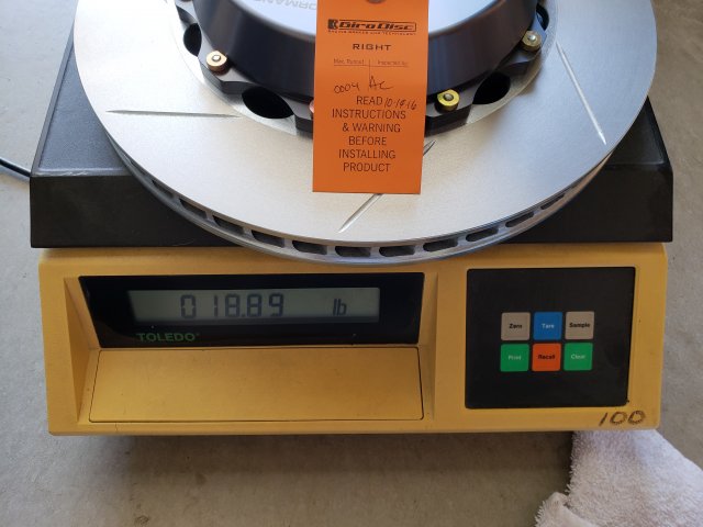

When talking about rotor weight differences of about 7-8 pounds between these makes how much does that really affect performance? Four wheels equals 28-32 total car weight pounds that must be accelerated and decelerated - a relatively small weight difference that equals having about 5 gallons of gasoline in the car.
Is the discussion limited to this total gross weight difference of the car, or are their other forces in play?

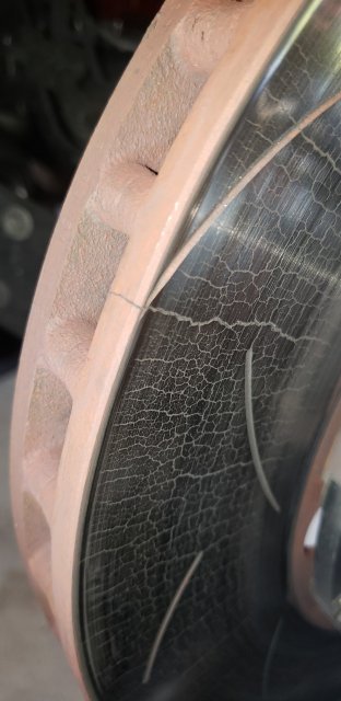

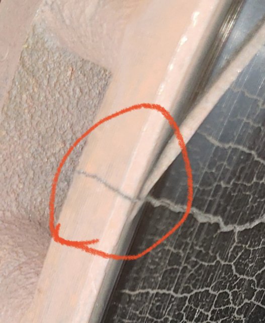

That is a Dba T5 rotor. It earned it, I ran these hard for several track weekends on Sebring and other tracks. I think there were 3 cracks in the outer portion of that rotor, the the 20230927_204559.jpg 20230927_204546.jpg one on the other side had one crack. You can feel the crack when they get to the outside edge as you probably know. I think I was at Road Atlanta when it happened so ended up driving it home to FL.

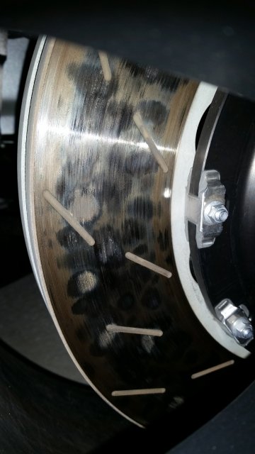

These pic is one of the first Girodisc front rotors I ran, and although the grooves are gone, you can see the difference in the cooling "paws" on the Dba discs vs the curved cooling vanes on the Girodisc rotors. I think they cool better/more evenly so lessen the likelihood of cracking. Wore all the grooves off the rotors (there are still traces of portions of the grooves) but not cracks. Seems the Dba rotors are harder, so don't wear as much, but they end up cracking. Again, this is with me in my WBRE that weighs 4700+ lbs with me in it, and I drive it pretty hard on track. The rear original set of DP rotors I have on back have held up well, although those grooves are almost completely gone. They have held up well given they have outlasted two sets of front rotors and I am now on the third set of front rotors not counting the OE rotors that I originally replaced. The OE front rotors seem really soft, and are exoensive.
Either Girodisc, DP, or Dba front rotors are a great choice. I just installed a new set of Girodisc front rings and have a new set of Girodisc rings to go in the rear, although they are still working will even with the grooves gone. Long answer to a short question.
Interestingly, the OE front rotor hats are still black, whereas the DP hats are now purple from heat.
Sorry, it's unclear which rotor it is in the first picture (the cracked one).

All of my Girodiscs on several of my cars have purple hats after a few sessions. I think it's the anodizing they use.

Ur confused with sprung weight and unsprung weight. 30 lbs of sprung weight isnt that much. 30 lbs of rotating mass is about 250 lbs of dead weight removed.
30 lbs of rotating weight off ur wheels makes a HUGE difference bro..... HUGE!!!! I had this discussion with an NHRA dragster tech one day at the track. He was the head crew mechanic of this car going 280 mph. I asked him about the rotating mass and how it applies to dead weight and he told me it was 7-8x compared to non rotating mass.
That wasnt something I read on the internet that was right from his mouth! I said 7-8x? He replied yes 100%.
Well CDT rotors are set to take 60lbs off of a Challenger/Charger...
I'm going to dare claim 400-500lbs equivalent, but take it for what it's worth.

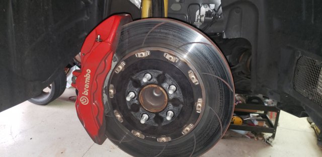

Update- my DP rear rotors are now devoid of grooves, worn completely clean, and still working and flat. Just now starting to show heat checks after using Hawk 70s for their entire life. Highly recommend this upgrade (not the Hawk 70s except for track) if you drive the car hard, as they dissipate heat so, so much better than the OE one piece rotors. I have new rings to install soon.
