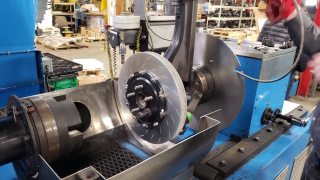

We've been testing various iterations of core design, coatings (more on this in a bit) and slight variations in material, both on the brake-dyno in Detroit as well as on-car testing with @BULL's Challenger. And while there was a certain level of success in that testing, our goal is not to deliver anything short of 100%. If we weren't trying to satisfy halo-car drivers, for cars that weigh 4400lbs and can achieve 200mph, we might have been done ages ago.​
(Fun Fact: One of the DOT standards for brakes is to test a car at BOTH 90% Vmax and Gross vehicle weight - Who does this?)

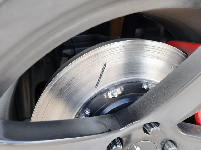

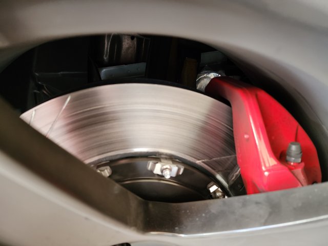

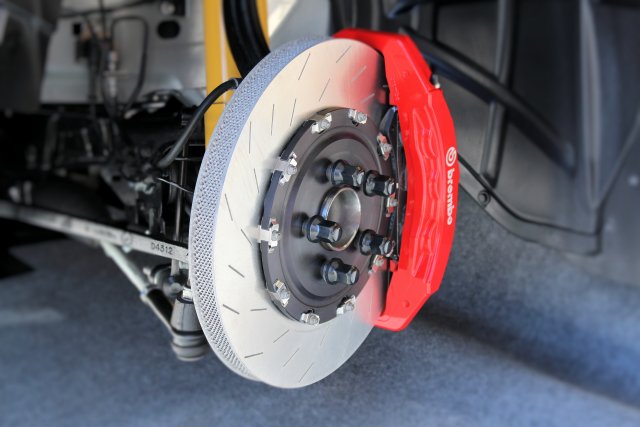

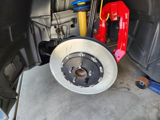

(A couple of on-car shots of two different iterations)
