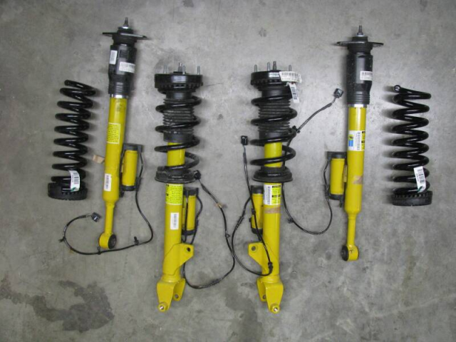

In the meantime I did some digging into the Adaptive Damping Suspension (ADS) in these cars. I started looking for a standalone system that would use the Bilstein shocks and allow the independent control of the rebound and compression functions. Unfortunately there isn't anything publicly available on Bilsteins' website (even doing a little backdoor tactics).
So here's what they gave us - note the leads to the tops and bottoms of the remote cylinder, those are the (electromagnetic(?)) adjustment for the valving. For reference Bilstein typically uses a monotube design for their shocks, which typically limits the amount you can lower a car and maintain functionality.

Another interesting note is that Demon uses four unique shocks (which are available through Rockauto at $600 each - LOL):
68316053AA - Rear Left
68316054AA - Rear Right
68316052AA - Front Left
68316051AA - Front Right
Meaning that it may not be a simple software change. May not. Or it may be but only within the design limitations of the standard HC/RE ADS shocks. But, again (as above) simply swapping part A for part B or changing some flags in the BCM may not be sufficient or effective, or at least as effective as an all Demon suspension swap.
For your additional reading pleasure I've added some files on the ADS shocks that I found from a 2015 thread on the other site. From what I have seen these cars don't react poorly to having the shocks disconnected, trouble codes - sure, but they can be swapped out. So, if that's the case than there is a potential to disconnect from the control module and manually manipulate the settings (assuming they are indeed 12v electromotors).

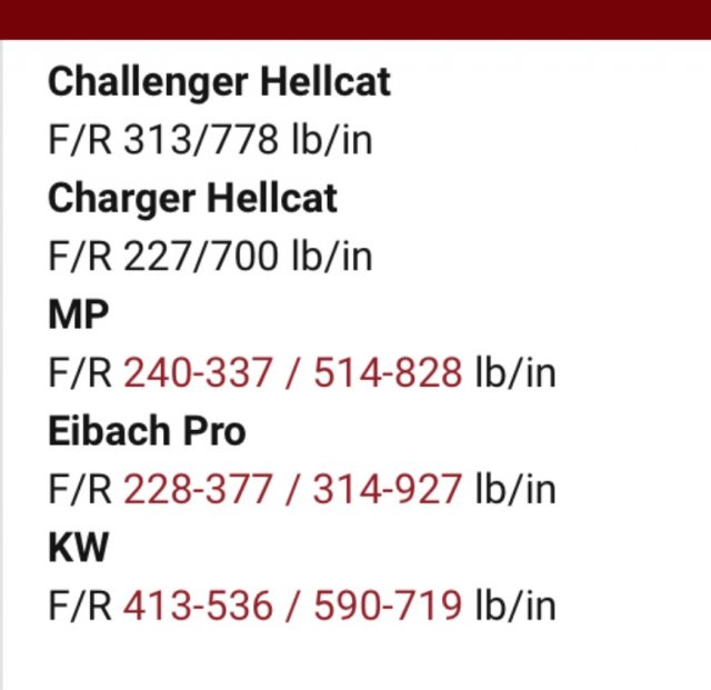

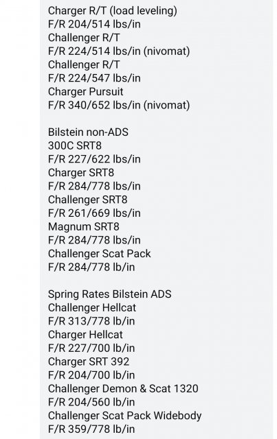

The linear rear spring rate of 778 lbs/in on the HC is the most stiff of the Mopar family.
Progressive rates available that are better ONLY on full compression are:
MP 514-828
Eibach Pro 314-927
Up front where the weight of the car is, the HC is soft at 313.
KW shines above the rest here with their progressive rate of 413-536.;)
MP 514-828
Eibach Pro 314-927
Indeed - chart attached for reference.
But, its about how the energy is managed. And until we can start adjusting our shocks independent of the stock parameters we are stuck testing other methods. A 50/50 bias in the rear makes the spring behave in a very neutral fashion which is great for a Demon - in the instance of using a HC/RE (as delivered) in Street mode we have to consider that the potential compression is going to be significantly softer than a Demon in Drag mode. Which means that locking out the rear and preventing squat is a reasonable objective, while leaving the front loose. It is a mechanical lock-out procedure for a suspension with very little room for adjustment to begin with - a simple case of fucking with the cock you got, not the cock you want.
For those interested the distance between the stock HC/RE rear coils is 3/4" at full droop (no tire) - so 1" booster blocks should squeak in there with a bit of lube (LOL).
8,593
52,818
To supplement your thread, here are the aftermarket spring rates. IMG_1227.jpg

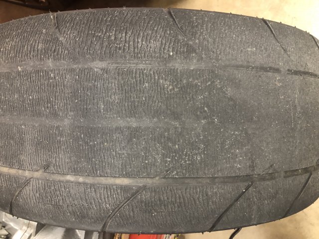

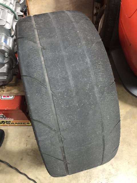

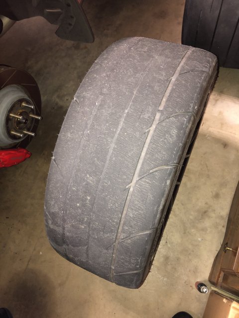

This some of the reason these tires looked like this after this days “practice” lol? Not worn evenly across?
95AFE868-BF24-4077-8E1D-7ACEF9D6CC0E.jpeg 4DE22747-3F32-45A8-904C-7A1AD9C512EC.jpeg DE1A7B9E-7870-416D-AF8F-38CB8A23ED4E.jpeg

I would imagine so. Possibly your toe setting a bit too. But mostly camber gain when it squats, exacerbated if the car is lowered. Why pay for the whole tire if you are only going use 3/4 of it?
The gentlemen who is going to set my car up and I had an in depth talk today. They are working on it this week. Does anyone know if taking the camber to one degree more than spec negative without any other adjustments will change the toe? Regardless we are going to see what happens if all four need -1 more, since I have the full set of AAD adjustable arms front and back.
If that is the inside of that tire, what does the other side look like? What did the track look like?
