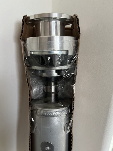

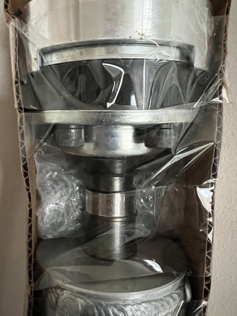

I have had this sitting in my garage for around 2-3 years. According to dss this is the updated one. I have the dss carbon fiber one on now. Once I get to 60 plus mph it starts to vibrate some. Some people are stating the cf and aluminum one weigh the same. 25-26 pounds. I just put the aluminum one on the scale. 31.2 pounds with the box and included hardware. But I also read that direct rotating weight straight from the engine or transmission is not as bad as extra weight on the corners. Ie brake rotors, wheels, tires. Is that true? Is the dss aluminum shaft good?
