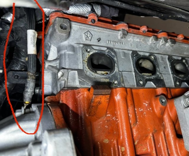

Check the main ground from the transmission bell housing the the shock tower. That will cause all kinds of issues if it wasn’t reconnected when trans was installed
From my car. That’s a giant ground wire
If you can’t get the car up in the air, remove the wipers/cowl and yank on it from up top (with battery disconnected)

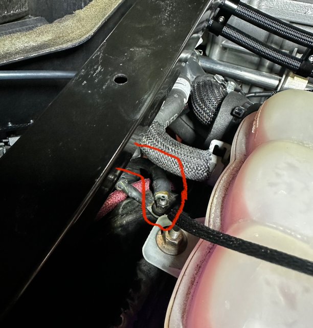

That was the first thing I checked it was the only common in this problem The secondary wire that is connected with the the ground at rear of block to cowl is the one I disconnected and the light and charging system goes back to normal ?
Here’s a pic of it from up top I just snapped for you
So it is connected to the transmission?

Left Battery connected Pulled grond at trans Motor has a redundet ground from front of engine to shock tower grounding point for jumping car
