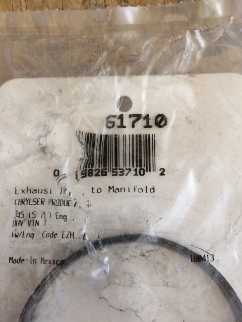

On the 6.2L, I can’t seem to find the part for the donut gasket between the headers and the cat down pipes. Does anybody happen to know an aftermarket equal alert?
I have the mid pipes off on my Trackhawk right now and I’m staring right at a gasket that goes there.
All of the OEM part call outs don’t list a gasket in this location.
Thanks in advance.

You can use nothing at all like most do or use high temp silicone. I have never replaced it when putting cat deletes on
I think this is what your looking for ?
Same part for both (L & R) sides.

My catless mid pipes that I got from Stainless Works came with the doughnut exhaust gaskets your talking about as well as my Borla S cat back, you could call any of these companies and they’d probably sell you some doughnut exhaust gaskets, even a good muffler shop should have them in stock

Dude. You are THE best. I’ve asked multiple forums and you are the only who had a part number. Fits like a glove.
Glad I could help, I had already been there & done that :LOL:
