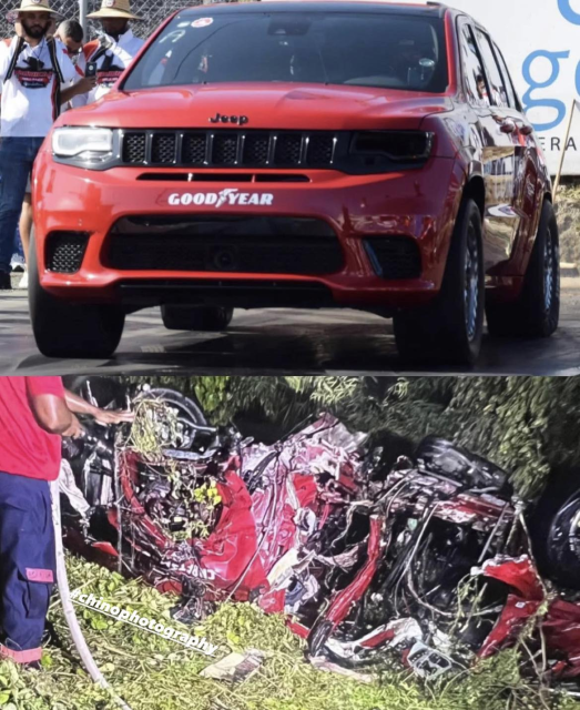

This was a Demon Performance build truck I believe and at one time it was the fastest Hawk. Hector Zeyas was the driver/owner. The whole run looked squirrelly didn't seem like very good track prep guess he didn't have time to pull the chute. RIP.....

It almost looked like an axle or something broke. To take a sharp turn like that in the big end is fairly rare otherwise.

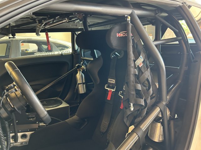

Tragedy. As far as commentary goes… questions about whether forgoing some safety measures could have been a factor. I don’t know but if that was the case then that’s something to respectfully talk about. Personally, I have done everything possible to do what I can to protect myself. With the safety equipment that’s available out there there are a bunch of different levels to choose from. Helmets…. A cheap helmet is heavy. An expensive helmet is light and exponentially safer from a broken neck potential. A $300 Kirkey seat will keep your ass in place but does nothing to protect your head and neck. A expensive seat like my Raceteck has a padded wrap around as a part of the seat to surround your helmet instead of it slamming against the roll cage repeatedly during a high speed rollover. That conversation could go on and on about properly built roll cages and fire protection, etc. I don’t know if any of that could have made a difference in this case. I do know one thing….. I will never run at a track that doesn’t have a proper concrete retaining wall all the way to the turn off. Those drive thru them and over them Armco rails that send a crashing race car into the woods are shit.

He had to have a cage or he wouldn’t be allowed to run at those speeds. Once you see parachutes the car is going 150mph+in the 1/4 so a cage is also mandatory.

@BigSwede I would think so too. Look at the mangled picture, what do you think?
The guard walls at that track, I read that they are apparently hard plastic filled with water.
It does not appear that there was a cage in that car. If you don’t have a cage with a supporting bar behind the seat, how do you attach shoulder harnesses. If you don’t have harnesses, there’s no way to secure a helmet restraint device (now required). Many tracks (especially ones with shit guardrails like those) do not enforce NHRA safety rules. You choose to run at your own risk. This is the risk 🫤. That car did not have this. If it did there’s a chance he might still be alive. IMG_8069.jpeg

I said he had to have a cage thinking this was in the U.S. but it appears it was in the Dominican Republic so I’m sure their rules are not the same as they are here.
I watched an in car video of him and there was no roll bar and he was using just the factory over one shoulder seat belt. I do not know when that video was taken but it looked like he launched hard so sadly it seems like he might not have had the proper safety equips for the speeds he was running.

There was no cage in the truck and the chute was because it wouldn’t stop otherwise.
