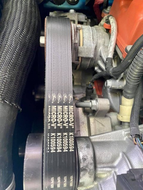

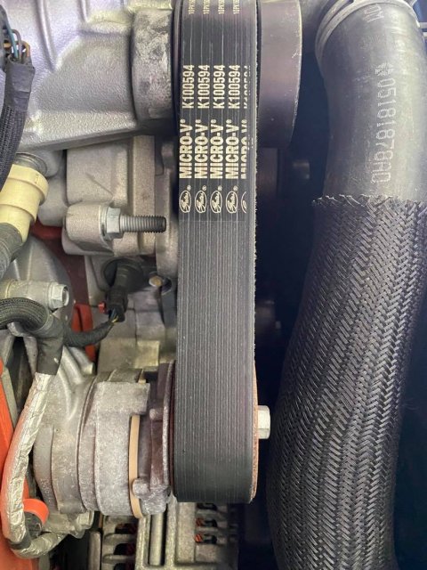

The 594 belt worked and dont have any belt slip but maybe I need one a little shorter?But anyway it runs great and gave me 2lbs. more boost so now I have 2.85 upper and sleeve running 17lbs. Any thoughts?

Should be fine. If you go with blower spacers or aluminum idler pulleys which are slightly bigger, it will be perfect

I will I have driven it about 100 miles so far and it runs great.....but I guess I had a brain fart after looking at the pics. I'm not sure if the belt should be a little shorter or longer ...lol
Yeah, your belt is on the lose side, but the spacers will take up some of the slack.
