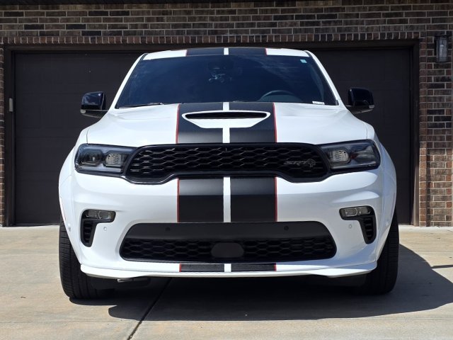

I installed fog lamps on my 2026 DDHC Jailbreak. Below is the complete parts list and step-by-step process.

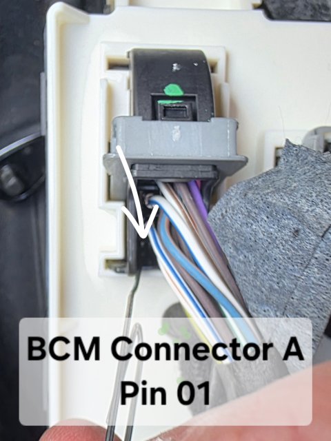

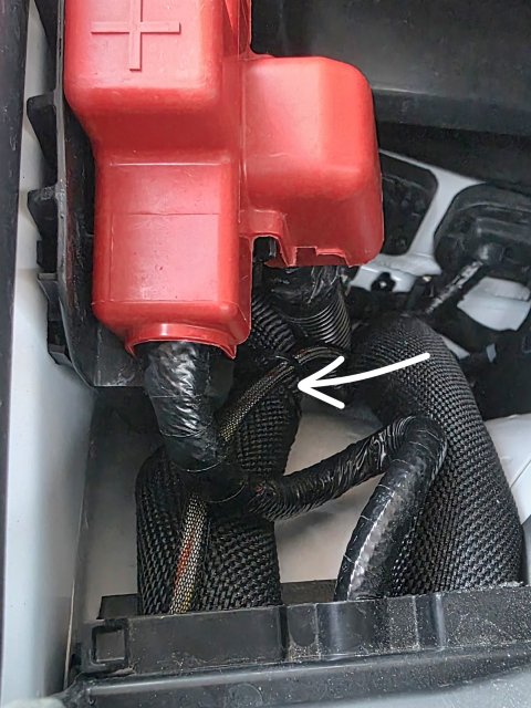

VERIFY EXISTING WIRING
To check if your Durango already has fog lamp wiring:
Option 1 (Harder):
  • Pull back the passenger-side fender splash shield and inspect wiring (see reference images).
Option 2 (Recommended):

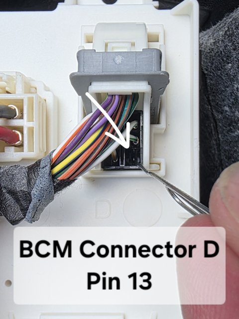

  • Inspect BCM connectors:
    • Connector A - Pin 01
    • Connector D - Pin 13
If fog lamp wires are present → No bridge wiring required

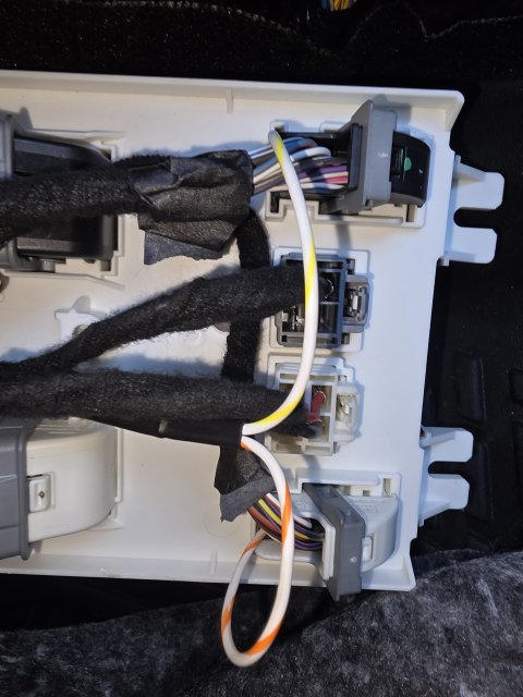

BCM ACCESS
The BCM is located behind the passenger-side kick panel near the door.
Steps:
  • Remove the plastic kick panel (pull outward from rear edge)
  • Remove the silencer panel under the glove box (3 push pins)
Once BCM exposed:
  • Remove two 10mm nuts at the bottom of the BCM
  • Gently pull the bottom outward, then slide the BCM downward
Note: No connectors need to be unplugged to lower the BCM for inspection

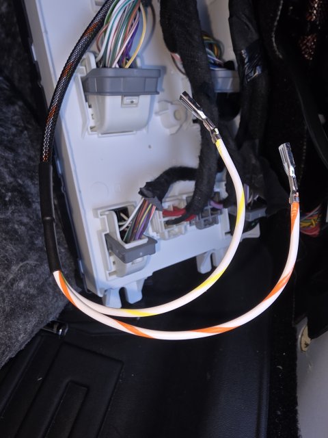

ADDING MISSING WIRES (BRIDGING)
Step 1: Disconnect Battery Ground
Step 2: Terminals Required
  • (3) Male terminals for Front End Module 16-pin connector
    • TE Connectivity 1718760-1
  • (2) Female terminals for BCM connectors
    • SNAC-A061T-M2.8
Step 3: Run Wires
  • BCM Connector A Pin 01 → White/Yellow (Left Fog)
  • BCM Connector D Pin 13 → White/Orange (Right Fog)

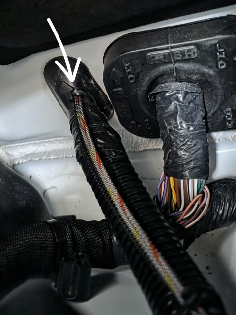

Step 4: Route Through Firewall
  • Route both wires through the rubber firewall grommet into the engine bay
Step 5: Install Female Terminals in BCM Connectors
  • Locate BCM Connector A and BCM Connector D
  • Identify the correct cavities:
    • Connector A – Pin 01 (Left Fog)
    • Connector D – Pin 13 (Right Fog)
  • Prepare your wires:
    • Strip a small amount of insulation
    • Crimp the SNAC-A061T-M2.8 female terminals securely onto each wire
  • Insert the terminals into the BCM connector:
    • Push each terminal into the correct cavity from the wire side (rear of connector)
    • You should feel or hear a click when the terminal locks into place
  • Gently tug on the wire to confirm it is fully seated and locked
⚠ Important Tips
  • Do NOT force terminals—if it doesn’t click, it’s likely misaligned
  • Verify orientation of the terminal (they only insert one way)
  • Double-check you are in the correct connector and terminal location before inserting

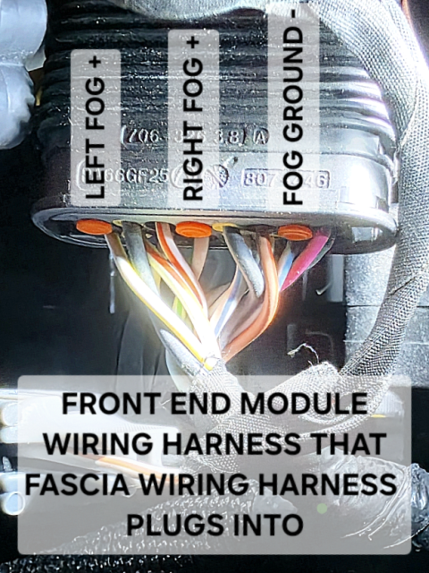

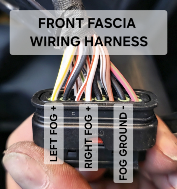

Step 6: Pin Front End Module (16-Pin) Connector
  • Locate the 16-pin Front End Module connector (body-side harness)
  • Identify correct orientation:
    • View from the wire side (rear of connector)
    • Lock tab facing downward
    • Pins numbered left → right
  • Identify the required cavities:
    • Pin 1 → Left Fog (+)
    • Pin 4 → Right Fog (+)
    • Pin 7 Ground

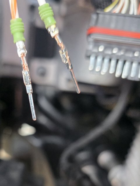

Prepare the Wires
  • Slide a 1-967067-1 wire seal onto each wire before crimping
  • Crimp the 1718760-1 terminals onto the wires using a proper crimp tool
Remove Cavity Plugs
  • Locate the three orange cavity plugs in Pin 1, Pin 4 and Pin 7
  • Carefully remove them using a pick or small tool
  • Do not damage the connector housing
Insert Terminals
  • Insert each terminal from the wire side (rear of connector):
    • Left Fog wire → Pin 1
    • Right Fog wire → Pin 4
    • Ground wire → Pin 7
  • Push firmly until you feel/hear a click
  • Lightly tug each wire to confirm it is locked in place
⚠ Important Tips
  • Double-check orientation—this is where most mistakes happen
  • Do not force terminals; if it doesn’t click, it’s not aligned correctly
  • Verify pin locations against your fascia harness before final assembly
  • Ensure the wire seals are properly seated in the connector

Thank you. Unfortunately no. 2023 was the last model year for fog lamps on the Durango. Dodge quietly eliminated them. I don't believe they were ever an option for Hellcats.
