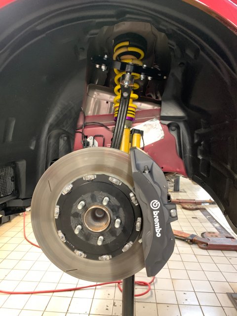

I have Demon performance rotors on the rear and race brake rotors up front . I have Z26's on all 4 corners but will be replacing them soon . And yes those are demon calipers on the front .

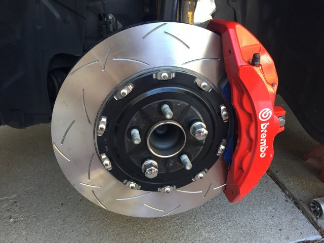

Yes and easily swap out my front Stop Tech for the OE Brembo pads on track days. I actually bought a hardly used front set of backup OE Brembo pads for a song. I keep the same set of Hawk pads on the rear for both street and track.
DBA has a pretty good explanation on their web site about how they are designed for cooling.
