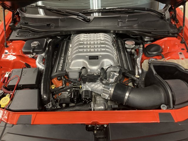

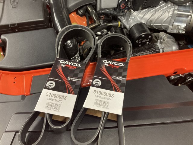

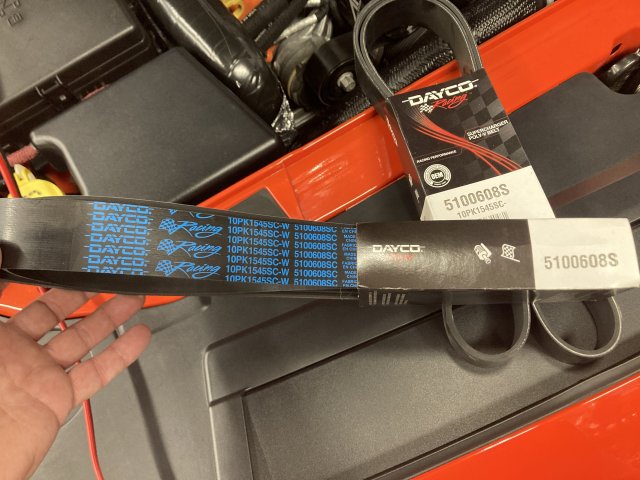

I use these belts, they are made for supercharger use, they hold up well and I turn my superchargers pretty hard, used same one on my whipples as well when I was running them.

Are @16GoManGoHC2 for stock blower pulley diameters?
That size belt fits with using the AAD Idler pulley in center mounting hole with +10 lower with that 2.74 Satera Griptech prepped upper with 1/2” thick FI Insulator Spacers. Blower making 25.5 psi of boost very little belt dust.
Also fits +10 lower stock upper and no spacers or idler pulley.

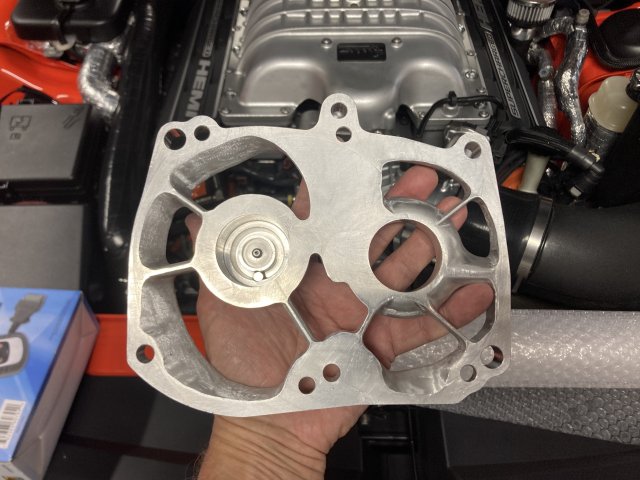

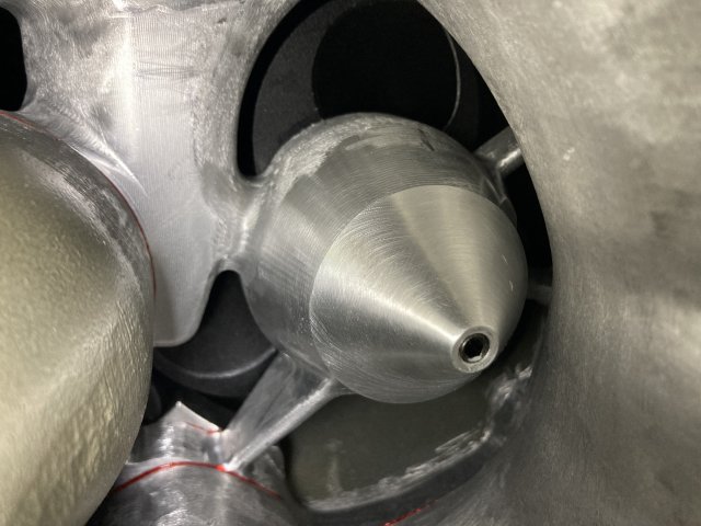

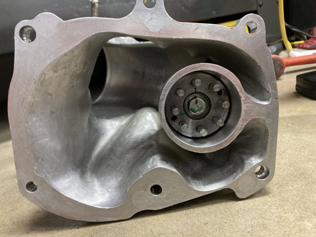

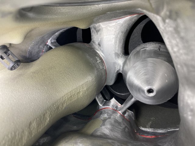

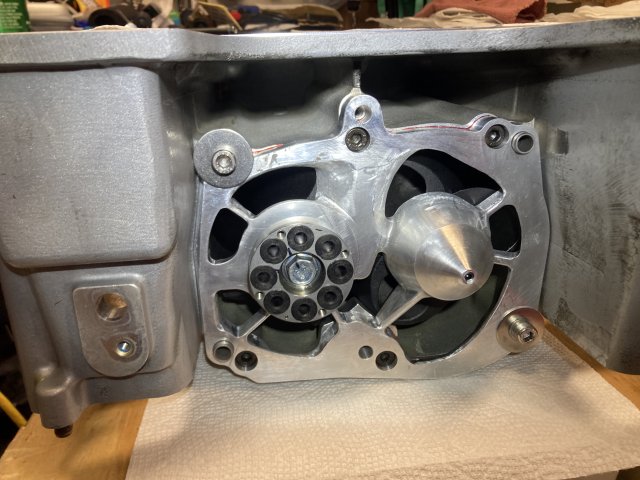

Yes, 25.38 to be exact with my hand ported 2.7 snout and 105 TB, has my custom billet 2.7 inlet plate with oiled bearing, the thing is singing but staying happy so far!! Have to try the SDG snout and NW 108 TB someday.
