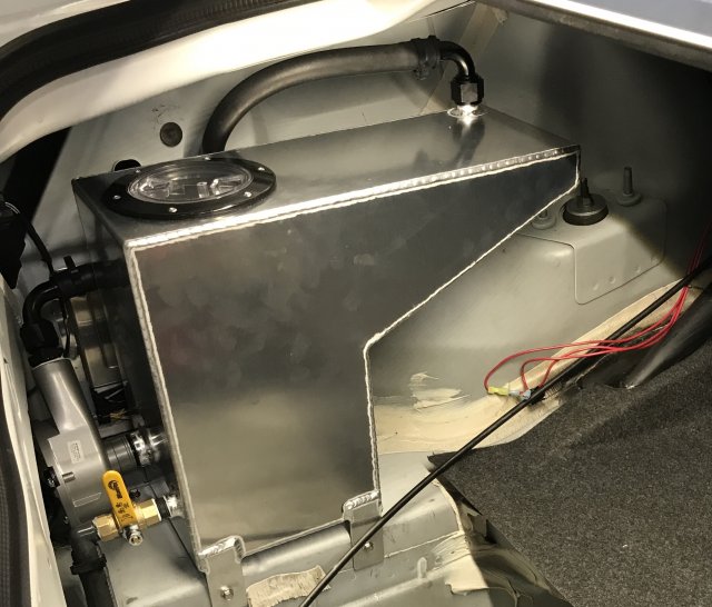

My Charger is suffering from high IATs at the top end of the track. I've had a legmaker and a heat exchanger installed. The temperature has come down but not enough.
Any advice?
^^^^ or Chiller

The FI Interchiller has a drag only mode that will prevent the AC condensing. He wasn’t doing it right. A properly installed chiller is the way to go but going that route is a lot more money than a icebox. Either way… the goal is to prevent timing from being pulled due to high IAT on the track. They both will accomplish that.

Leaking on track - not good but a chiller with the lines insulated will not do that.
Mine chills down in the 30's & lowest of 28* & has never leaked on the track.

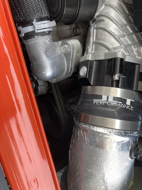

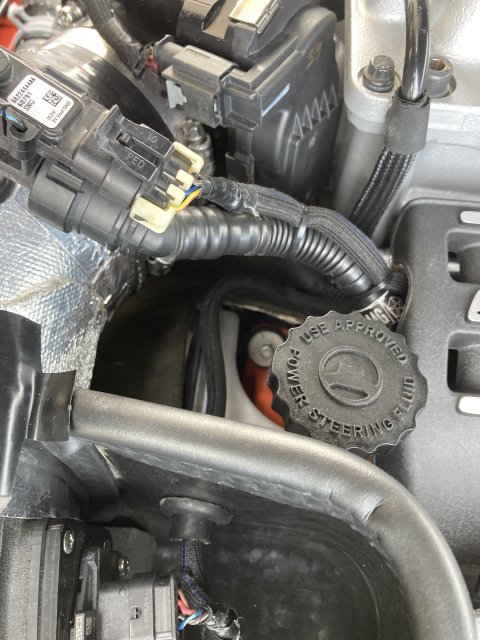

Here’s something I did to keep intake pipe and TB away from the hot air of the radiator fan, lowered my IAT by 15-20 degrees, the intake pipe and TB stay cool now. I can make them but the insulating material Pyrol is expensive and a bit hard to get ahold of. Snaps in place under the brake lines. I’ve made them for hyd power steering and no hyd power pump Challengers. C2B60DB0-2BEC-45A8-8E61-AFE52AB29AE7.jpeg 94ECF551-A0E8-4E0C-A6FC-0AD650BC8E32.jpeg 010346FE-7513-42AB-B435-E1C77F2FA27E.jpeg 9B521EBE-FA97-47F8-B5ED-CA81E4E882FF.jpeg

Here’s something I did to keep intake pipe and TB away from the hot air of the radiator fan, lowered my IAT by 15-20 degrees, the intake pipe and TB stay cool now. I can make them but the insulating material Pyrol is expensive and a bit hard to get ahold of. Snaps in place under the brake lines. I’ve made them for hyd power steering and no hyd power pump Challengers. View attachment 60321 View attachment 60322 View attachment 60323 View attachment 60324
It's hard for me to tell exactly what you've done there?
Yea, hard to see it installed, it’s a heat shield under the intake pipe from air cleaner box to under the inlet snout behind the pulley. Keeps the hot air from the radiator from blowing directly on the intake tube and underside of the snout. Top side is painted flat black with high heat paint. It’s slick, stays in place and can be pulled out when needed in seconds
