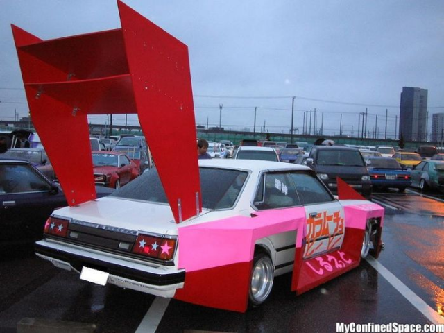

Oh and it should be named the Hellcat ADM.
Do you REALLY want these guys being attracted to it?
