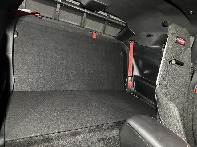

Mocking up my own rear seat delete. Probably going to make it out of plastic sheets. Right now, mocking it up with foam board, 1/4” plywood. I have black carpet - I might make it out of wood/cover it for now to see how it looks. Willing to share template when done (mail). With carpet, adhesive, wood, have about $65 in it. Should weigh under 2lbs when done. Speedlogix is made out of mdf, weighs 24lbs, and is $400.

Just carpeted it.
Very cool.

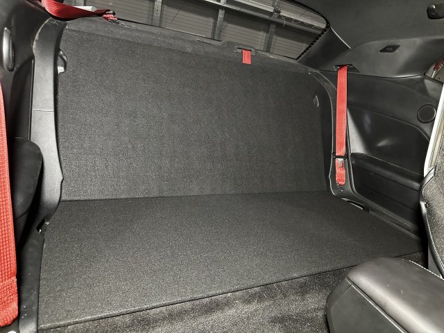

Can’t believe how amazing this turned out.

I’m sure I’ll make improvements, just an idea I had over the weekend. Got everything Sunday and started making the templates (contour gauges are your friend). Very pleased with how it turned out

Looks good!

Looks great!
And if you you decide that you want to quiet it down a little - 40 oz. Jute lining from Ebay. Seems to be much lighter than the sound deadening mat and pretty cheap. I used 2 yds and it was the perfect amount for both the back panel and the "seat" bottom. And under $40.

How did you attach the covers? I don't see any fasteners.

Lol no. Hardware through it behind the carpeting. Bolts from back on trunk panel, front/bottom is push pins.
