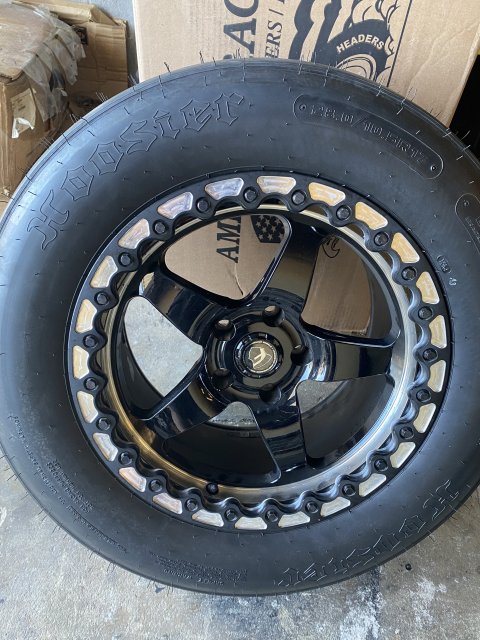

2020 hellcat charger widebody
Hoping these work a bit better than the 305/45-17 ET Street R
28x10.5-17 Hoosier DBR
Next to try will be either the 28x10 bias ply slick, or the 315/50 ET Street R
All I want is a successful 1st gear launch haha
