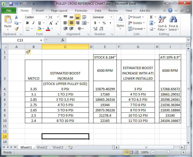

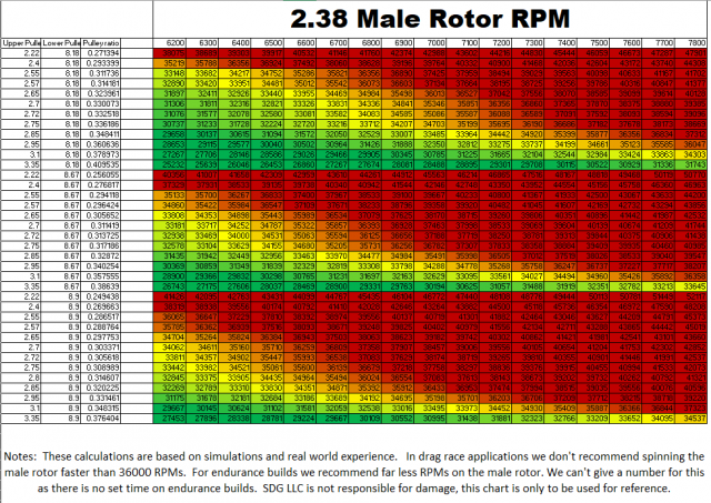

8.9/2.69 x6400rpm=21,174. Stock with 3.35 upper ~ 15,600 at 6400 rpm engine speed. Pushing the limit imho.

SDG has a graph it is on the site for rpm

So I have a 2.69 on there now. Kong is doing a full port and race bearing rebuild. 108mm throttle body, and long tubes are inbound. Car has a chiller. Wondering if I’ll lose power without pulleying down a bit more, and what I can realistically pulley down to in the “safe” male rotor rpm range
