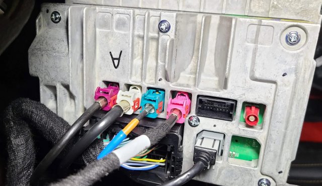

The head unit's rear layout for the male FAKRA connectors is as follows (borrowed from another forum post but the header setup is the same:
For my purposes here, I'll use the color names from Left to Right: Purple, White, Blue, Pink, (Red: not used; Gray is the USB header)
I've found a couple of conflicting interpretations of exactly what these connectors map to. In my own testing (again, 2023 Challenger UConnect 8.4 with Nav):
- Blue is the satcomm connection for both GPS satellites and SXM radio. If this antenna is disconnected, all satellites drop. This can be verified for Nav by going to Nav > information > current position > show GPS Info. This will display the current satellite array, how many are locked, and signal strength for all. If the blue plug is removed, this drops to 0 over about a 1-2 minute period. Likewise, satellite radio is rendered inoperable, no signal. My assumption is that this leads to the on-roof shark fin antenna. Lastly, satcomm was unaffected by pink/purple connections either way.
- White is AM/FM radio.
Here's where it gets a bit more interesting:
- Purple's lead is a long cable that goes into the wiring pack and out of sight, endpoint unknown. Some forums/sites suggest this is 4G, others satellite radio, and others GPS.
- Pink's lead is a short ~15" cable that leads to the in-dash black shark fin antenna, mounted just behind the head unit. Different sites assume different uses for this - some say GPS, some say 4G/cellular.
In testing:
- Removing/reconnecting blue had zero affect on 4G signal strength, so I can assume the 4G radio does not use this header at all.
- Removing pink/purple together dropped the 4G strength from 5 bars to 3, but there's still a solid 3-bar connection and (dis)services such as weather alerts still operate.
- Removing pink alone had no effect on 4G strength, remained at 5 bars.
- Removing purple alone DID lower the 4G signal (to 4-5 bars, back and forth), but NOT as low as removing purple and pink together.
The data seems to indicate that the purple connector may go to the primary 4G antenna, and that the pink connector (to the in-dash shark fin) may be the internal 4G/WiFi antenna designed to transmit/receive from devices inside the vehicle.
The data also seems to indicate that the 4G card is able to utilize either the pink OR purple antenna leads for external 4G data usage, but that the pink (dash shark fin) is less effective than the purple primary lead.
Lastly, given that the vehicle still has 3 out of 5 bars of 4G service with all the leads disconnected, this tells me there's an on-card antenna (not surprising) that is used by default when there's no signal (perhaps specifically no resistance) detected on the external antenna lead. This aligns with the integration spec for the Sierra card. "The RX2 antenna diagnostic feature allows the AirPrime AR75520 to determine if the RX2 antenna connected to the module is: open, shorted or normal. The antenna connected to this interface needs to have a DC resistance to ground of 10 kΩ± 1k embedded inside", suggesting that if there is no antenna, it defaults to the internal antenna.
I expect that the above knowledge of an on-card integrated antenna is exactly what gave rise to your design - as unplugging the antennas doesn't stop the signal.
It looks from your post like you're using a different head unit that may not have an internal WiFi hotspot antenna (pink equivalent).
Questions:
- Does it make sense that the in-dash shark fin (pink) is the internal wifi antenna, and if so, that the 4G card could utilize it for external 4G transmission as an alternate to the primary (purple) antenna lead?
- Any reason to craft a second cellcomm killer for the pink FAKRA connector as well as one for the purple connector, or should the resistance detected on the primary circuit mean it doesn't try to broadcast on a secondary antenna?
Thanks again for the great info for the project, look forward to testing it and seeing if it solves the telemetry concerns.

When you pull the radio, please post a photo of the back of it, where the connectors are. For future reference.
This matches the photo in my second post above, with the one difference that there's a header between red and pink FAKRA connectors on the other one, and there's not on this one.

"OTA updates is just one." @Diboblo can't they be done without permission too?
Linda :)
Yes.
Essentially all over the air updates are done, without your permission. Once the packet is downloaded (usually over several days), it is resident and in some cases, will not let you use your infotainment screen, until you accept their terms and update. One cannot refuse the resident update. Nor, can one refuse to have it downloaded. Hence the desire to block access to the vehicle network.
I ran into this, with 18-45-01. It fucked my nav and I had to wait for them to send me a usb. THEN, it fucked my performance pages and leaves stupid yellow warning triangles, when I select a pre-set custom mode. Just another example of their many update failures.
