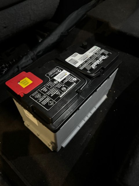

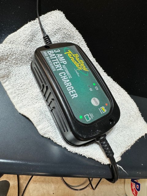

Turns out my culprit was a tazer and mpvi 2 plugged in. Need that obd 2 cable with a switch. Under warranty thank god.
Tender is now permanently attached
