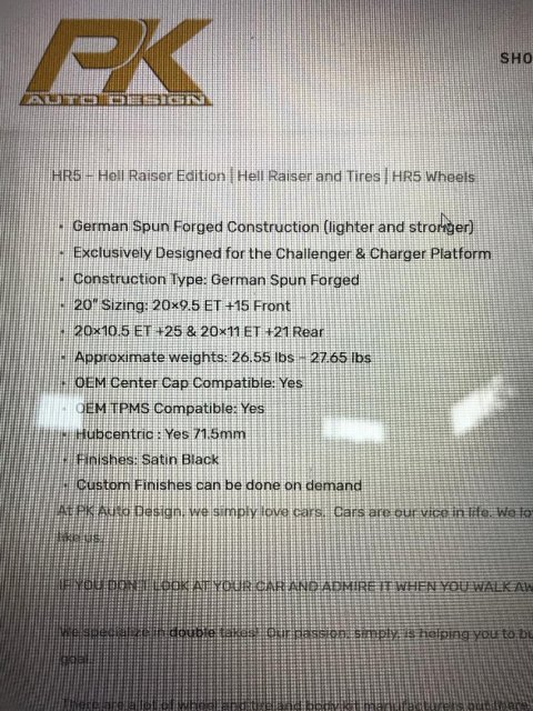

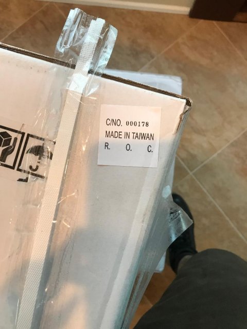

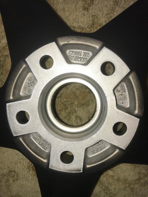

I just received my HR5's and was excited to open the boxes and see them. But when I saw the country of manufacture was very surprised and disappointed. They look fine, and received no damage in shipping (That I can see). I just had a bad experience with a set of Factory reproductions F77's where one was bent right out of the box, so I'm hoping all goes well with these. But am I missing something? Am I miss reading something? It does say "German spun forged construction" on website right? Do they make them in Taiwan and send them to Germany to be spun forged ??? :oops: . Also, I don't see a D.O.T. certification cast or stamped anywhere unless I'm missing it. Can anyone clarify if I'm wrong on all accounts here?

I noticed that and was a little disappointed as well. I guess German technology utilized by the Taiwanese.

"German spun forged construction" doesn't mean the same as manufactured in Germany. It's just a technology. It would be way more expensive if made in Germany. Just my $.02.

It most likely is made in Taiwan and finished in Germany
A lot of the crank/rods/pistons etc are done this way. Made in China and finished in the USA. But the China crank is $850 vs $1800 for the Made in USA crank.
Tariffs have leveled some of the playing field but its still cheaper to build many things in China/Taiwan and bring them back here.

Well I called PK yesterday during lunch. I was told 'German spun forged' is a fancy way of saying rotary forged but that's a copyrighted term so they can't say that. Was also told they were NOT D.O.T. certified, but a lot of aftermarket wheels aren't. It would be to time consuming and expensive to get them D.O.T. certified. Was told they can't come into the U.S.A. unless they have D.O.T. or JAL? or VIA? certification (Not a 100% certain of the last two abbreviations. We were talking on phone and I didn't wright down), which these wheels have the last two. Was also told they have the Japanese certification which is to a higher standard than D.O.T.

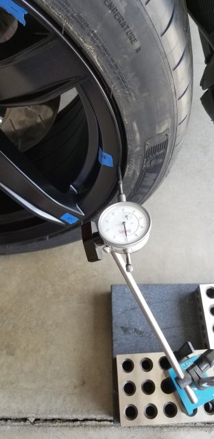

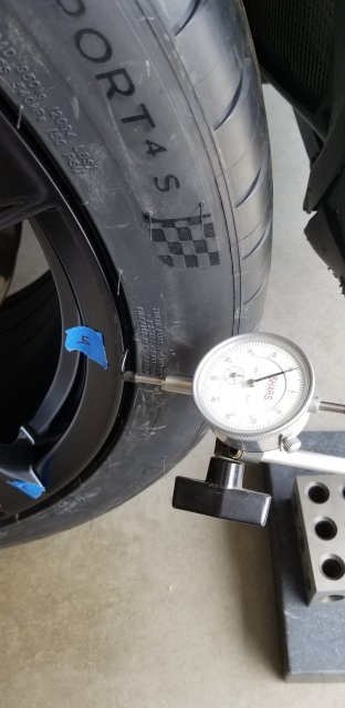

Here is what I did when I got some of the very first sets, because I wanted to know more about them.
I don't have the numbers available at the moment, but while they weren't as good as the O.E.s, they were generally within industry guidelines.

Damn Bull, some ingenuity and hell of a nice setup for home test. I did not even know you had these, just thought you were following with interest. I thought you were on factory slingshots at all times. So are these the ones you took to 174mph in Colorado?
