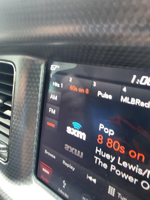

You would need to ask Dodge Cares about that. According to the SR at the dealership I go to they were replacing them regardless of warranty status/miles for original owners. She said they did deny 1 customer who was the 3rd owner of the vehicle. My car was just past the 3/36 and they put it thru without question.
I called Dodge Customer Care and they said no, they would not cover the replacement. Oh well, they did replace my windshield under their goodwill policy when I was outside of the 36k warranty. I figured they would not replace the screen.
For your reviewing pleasure (closer to 60% delamination): 5D4E3230-2AD5-4998-A9F5-85B2B8145222.jpeg

Wow, that looks really bad ! Surprised it's still working. Mine had about 1/2" at the top separating & it was making the system go nuts - like it was randomly pressing icons & selecting stuff. It was making me crazy driving around having random crap pop up :oops:
Sheesh, I would have replaced it long ago had it gone crazy like your previous unit…I too am surprised it works fine.
