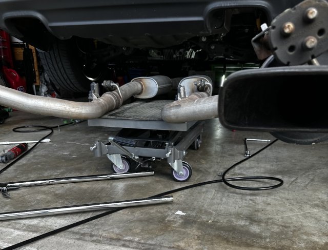

It doesn’t lol, installing a 3.09. My mid pipes are a tight fit, I have to whack them with a punch and hammer to separate them from the back end of the exhaust

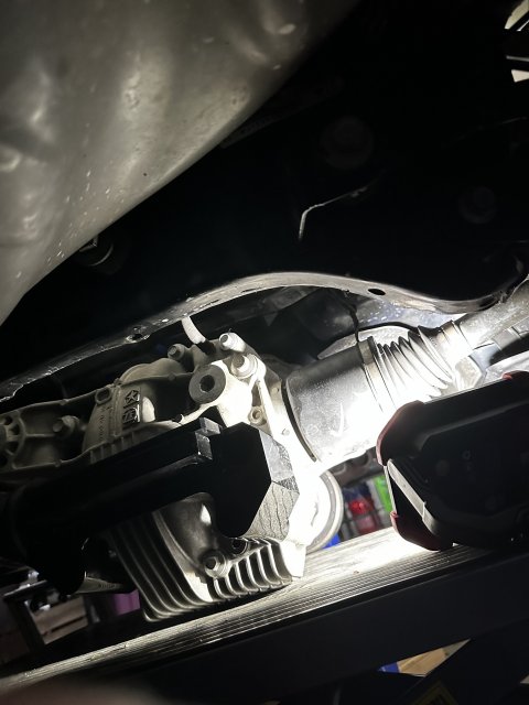

Almost out, taking my time, breaks. Have about an hour and a half into it with exhaust removal, draining diff

I need to get that little harbor freight red impact actuated transmission jack, cart is too big for this crap lol

I’m half tempted to lockout the diff while in there, but @zhc doesn’t have his diff locked out and runs 7s, so lol

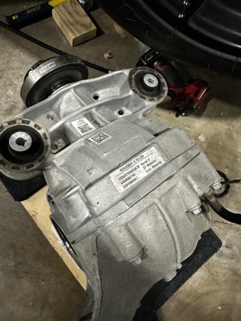

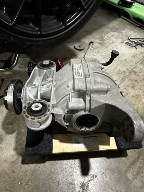

Proof I was in fact running a 3.70 with the a8 lol
