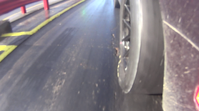

These Hoosier's stick pretty much every time at 22psi, they were wadding up pretty good Sunday. Probably could've used another lb.
I did have a bit a of learning curve with the Street R's with their stiffer sidewall. Found out real quick 22 is too much for them, 19.5 has been the sweet spot.
