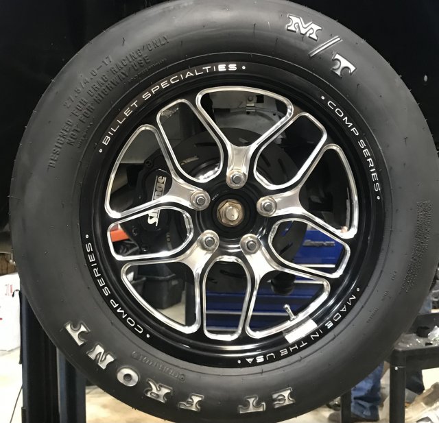

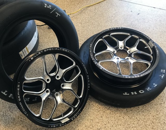

I just checked. My M/T Fronts (27.5” tall) are 12 lbs. Billet Specialties wheels are 10 lbs. So… 22 lbs each side for the wheel/tire combo. IMG_2996.jpeg IMG_2859.jpeg

In this case the tire is heavier than the wheel so more tire and less wheel probably wouldn’t be lighter. I do not like the larger sidewall on frontrunners.
