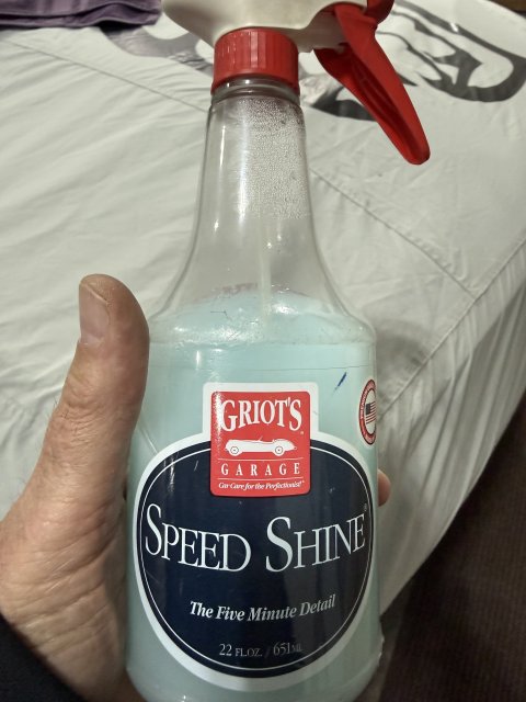

Use any clay you want. This makes a great “lube”. Be generous. When the bar looks dirty, play with it and bury the dirty. Just be gentle and pretend it is like a fine sandpaper. All should come fairly smooth without any stuff on the paint when it is right. It should not take too much pressure or trouble to clay.

Had not tried that, but I’ll start to chill my Soeed Shine. It smells so good, hope I do not get any other ideas.

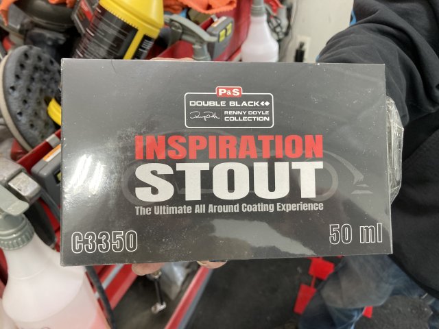

It's Friday, maybe Hunter needs some of this!

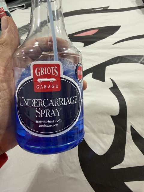

:love::love::love: I’m going out to do some Hellcat work tomorrow. In my world hibernation is when it gets real attention. Before the Speed Shine comes out this stuff happens under it. It is sort of magical. I’ll post up some pictures in the what have you done thread.
