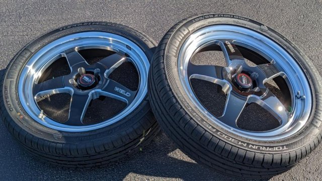

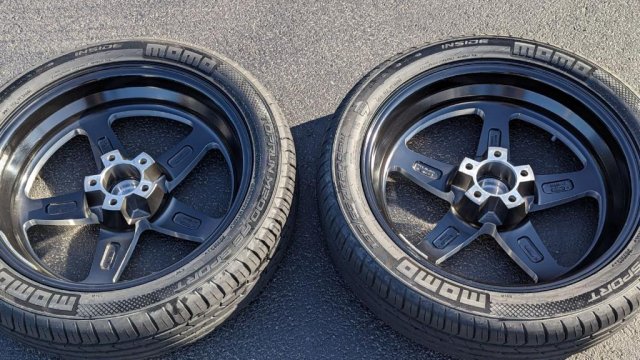

I thought they didn't make skinnies for the '21 up cars with the bigger brakes?
Atleast im not crazy, cuz thats my understanding too
