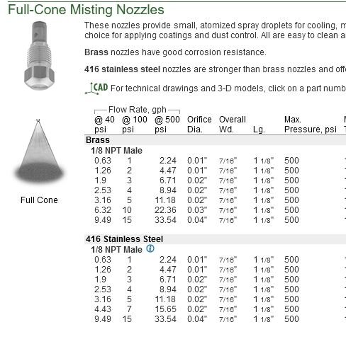

These worked great for me for years and have a filter screen. McMaster Carr.
16,915
52,955
