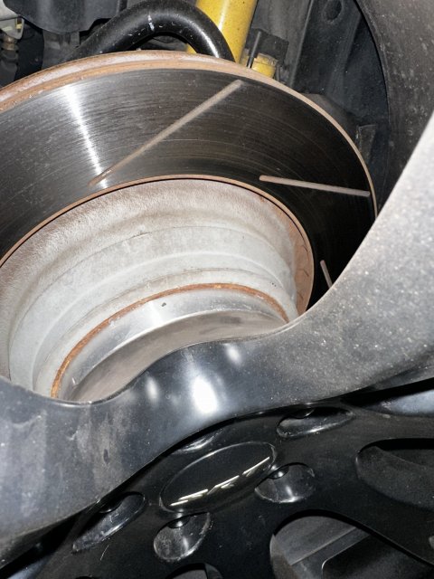

Here are my hub centric rings in my forgestars. You can see how much was needed to make the wheels align on the hub. The rings are aluminum, the rust is from the factory hubs sitting nice and tight in the rings. Last pic is my stock wheels on my stock bore hub centric spacers (with stock bore lip)
