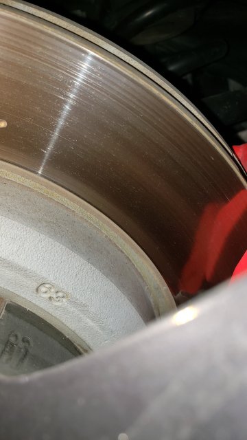

Pictures of your rotors would help.

Seriously, pictures.

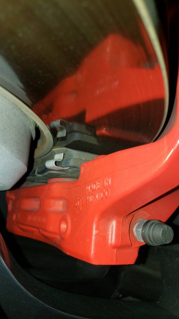

Note the wear strip on the pad, this is at ~15K miles.
