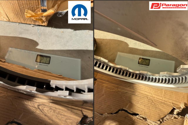

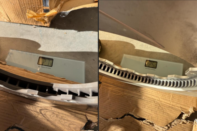

Using the Paragon Front replacement rings with OEM hats and ~3.6lbs weight savings per front rotor. Notably, the turn-in effort is less compared to OEM.
After bedding, the brakes felt "not as confident" on initial stopping and then I realized I was using the NOA Ceramic pads from Brembo (venture to say this is why the 390mm to 400mm front rotor)
I've got the semi-metallic on the way and can compare soon.
Overall, it's nice to the brake maintenance budget to pay $725 for the rotor ring set vs. $725+ for one OEM front rotor, and use the original OEM front hats.
OEM Rings + Hat (est. 31 lbs new and 29.2 lbs worn)
OEM ring: 27.4 lbs (worn, est. +1.8 lbs heavier when new for 29.2 lbs).
OEM hat: 1.8 lbs
Paragon Dual 2-piece Rotor Front Rings + OEM Hat (est. 27.4 lbs new 390mm and 28.1 lbs 400mm)
Paragon ring: 25.6 lbs (390mm ring)
2015-2020 (390mm): https://paragonbrakes.com/15-4-front-rotor-rings-15-20-charger-challenger-srt-hellcat/) as a direct swap from the OEM hats.
2021+ (400mm): https://paragonbrakes.com/2-piece-r...34mm-21-dodge-charger-challenger-srt-hellcat/
OEM hat: 1.8 lbs
ACDelco Dual Slotted Rear Rotors (350mm)
ACDelco:
24lbs Part# Gold 18A2677
Paragon: They offer a rear set with hats for ~$950 and replacement rings for $600.

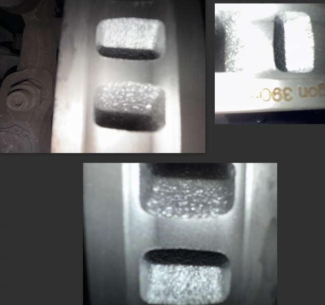

Do you know if they are a private label part from Gyrodisc?
I don't know but the Girodisc vanes appear to be different than the Paragons.
It would be worth a discussion on the metal materials too.
Paragon - CM-250 special formulated high carbon alloy cast iron

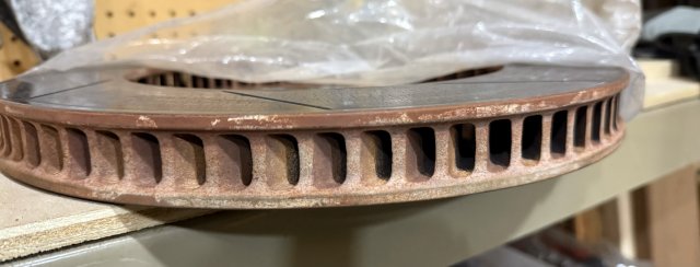

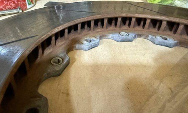

I've got a set of Girodiscs in the shop, I'll get a pic posted later today.
(Glad to see you still kicking around)
8,593
52,818
Giro’ outside and inside shots…
16,897
52,906
8,593
52,818
Dude! Where's all that rust from?
: p
HA! Not used in I don’t know how many years. Not since 2019 anyway. Left those for dead because they chattered a bit. I know they have not been on the RE. I think they just need hammered real hard because my current set does that (on the track) if you don’t bust down hard all the time.

Girodisc has a straight cut vs. the curved cut of the Paragon.
Paragon manufactures their rotors, given the large variety they have to match with hats.

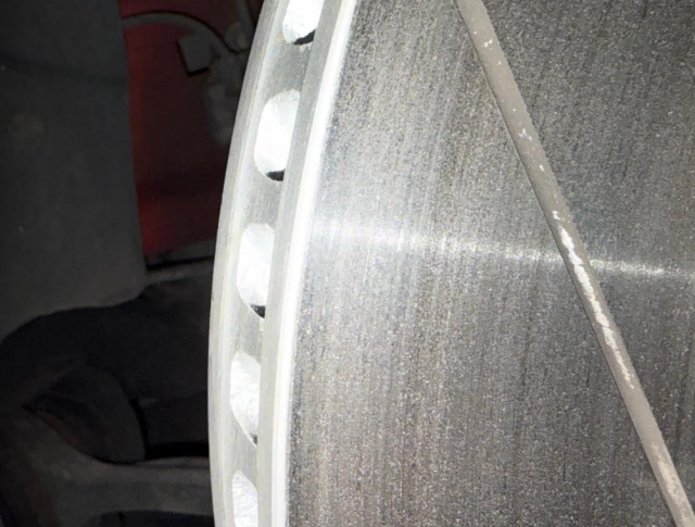

Here are a few more shots.
