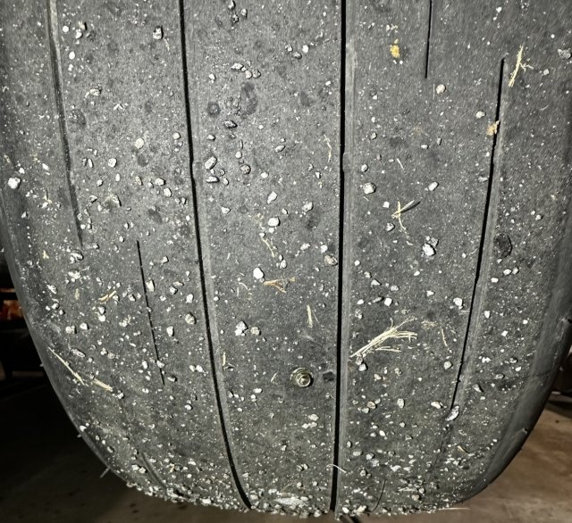

Picked up a fender screw in my brand new Mickey Thompson et street r drag radial. It's in the thick part of the tread, way inbound from the sidewall. Has anyone patched an ET street R from the inside? Obviously a regular plug will not work, especially for racing on the track where the prep could pull it out. Thoughts? Would you do it?
Also, has anyone re-mounted a tire on a beadlock that was already mounted before, and has the indents from the knurl?

Throw it out...

I had a brand new Ducati that got a very small screw in it (less than 200 miles)..the dealer said we can patch it on the inside...(are you crazy)...I said good patch it and sell it to somebody else...now put a new one on ....he still thinks I'm crazy...I never will drive ANY of my vehicles with a compromised tire...EVER

How much do you value your life/ car?

I have had many patches and plugs, never had a problem. But on your car..... Tough choice.
What is the worst that could happen? Check after every pass, and if it leaks, then you know. I might give it a shot.
I don't know about beadlocks, but heat cycled MT's are more fragile than new ones. I swapped rims and they tore off a chunk at the inside edge. It still sealed and I got maybe 40 more passes without any problems.

Way more than a price of a new tire

I wouldn't risk it if you plan to run on the track. 140+ mph puts a lot of stress on a tire.

Even a perfect tire...tire failure @ 100mph +..can be catastrophic :(
Me too. Maybe I've just been lucky

In a DR used at the track? I think thats the sticking point in this situation. I'll patch or plug a street tire used on the street no problemo.

Right, that is a good point. I have never had to patch a drag tire like this, fortunately never been in the position to have to make the decision. Would I do it? Probably, if the tire was close to new.
