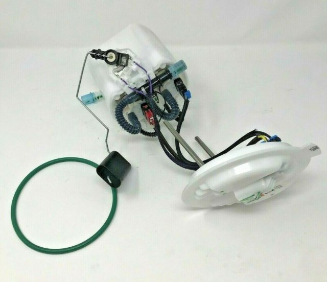

I was working on the fuel system for Go Man Go this weekend (2016 Hellcat) and like other cars it has a single pump that's fitted to a plastic bucket. There's a 1/2" line connected to the pump assembly that feeds the engine (output) and about a 3/8" line coming in from the right side that flows fuel over the pump presumably to provide cooling, but also keep the bucket full. This helps maintain adequate fuel around the pump in all driving conditions like hard cornering or hard launches.
The concern with buckets as it relates to aftermarket high performance fuel systems like the dual pump drop in unit is that they can drain the bucket faster than it can be filled, so they do not include one. The pumps are free standing in the fuel tank. As a result it's recommended to keep the fuel level above 1/4 tank if you plan to go WOT as fuel could slosh away from the pumps leaving them to suck air. Not good at WOT.
I'm curious if anyone has pictures of a Redeye/Demon/Trackhawk fuel pump assembly to see how SRT solved this concern as these vehicles come with dual pumps from the factory.

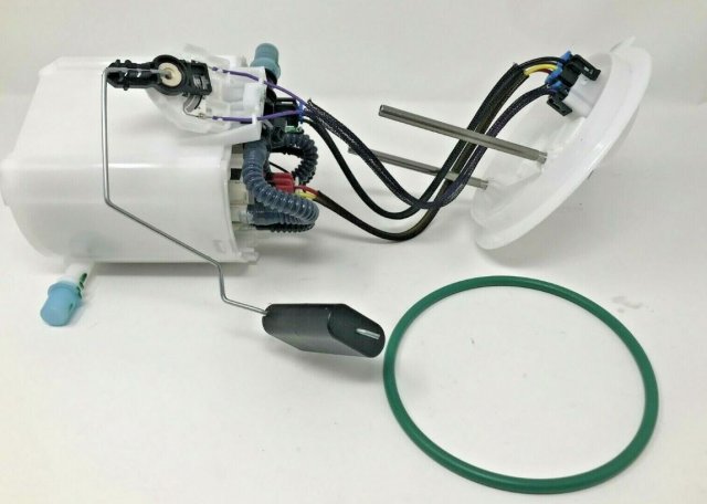

I think I found one on Ebay. Looks like they have the feed line to the bucket coming from the right toward the bottom to keep it full rather than pour over the top of the pumps.

I believe I read somewhere that the feed into the bucket comes from the cross tank transfer pump.
7,311
19,165
Indeed it does.

I just changed out the bucket assembly on my truck and on the bottom, there was a small screen filter and the pump was able to pull through the bottom of the bucket. Not sure if the one in the cars is the same or not.
