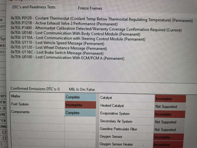

I check my dtc code with hp tuners this is what I got could this be problems with the BCM? And if so why cant you buy a bcm and they could program it with my car's vin#
6,129
40,319
Could that be from trying to unmarry and do you have to do some kind of reboot or reinstall original information?

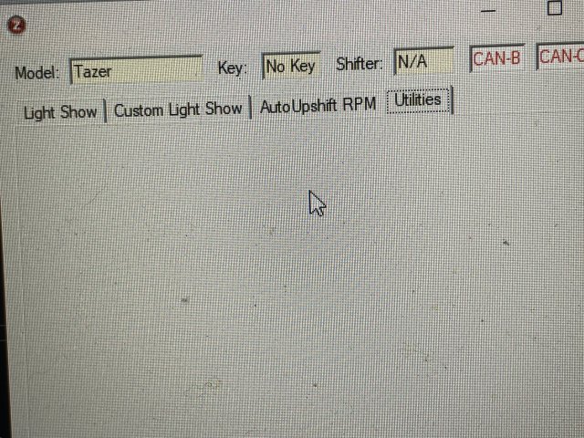

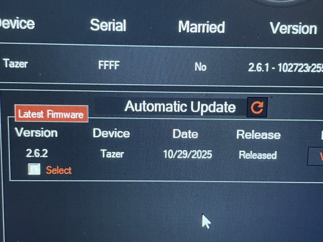

the first pic shows it's unmarried the second show no key I thought for the tazer to work you had to have a key to match the tazer.I'm not sure on that......thats the biggest problem I'm not sure of anything. Module Expert will take the bcm and check it out and if it's faulty they repair and use my Vin# to program the bcm
